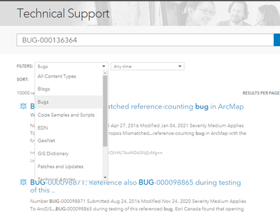

@KoryKramer  -  This link brought up the correct result Monday. Today... basically useless.
https://support.esri.com/en/Search-Results#search?q=BUG-000136364
Who do we contact to look into this?
Thanks,
Tom
KoryKramer
Esri Esteemed Contributor

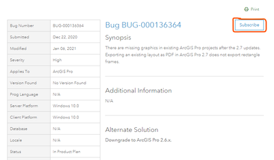

Hey Tom, search does work on the support site - be sure to use the filter dropdown and filter on Bugs:
BUG-000136364 is not returned in the results because it is new enough that it is still in the copy review process so has not yet been published to the site.  @LindsayRaabe_FPCWA BUG-000136364 is the bug number.  You can contact technical support if you would like to be attached to it.  Alternatively, you can check back on support.esri.com and when it is published you'll be able to click the Subscribe button which will set you up for status notifications.  Sorry about the inconvenience on this issue.
KoryKramer
Hi @LindsayRaabe_FPCWA The bug is now published here: https://support.esri.com/en/bugs/nimbus/QlVHLTAwMDEzNjM2NA==
You can visit that page and click the Subscribe button.
LindsayRaabe_FPCWA
MVP Regular Contributor
Thanks @KoryKramer and @TomBole for your assistance. I don't know if it matters, but I noticed in the BUG Synopsis that it only refers to rectangle graphics. We noticed the same problem occurring with line graphics too but I couldn't see a way to contact them directly on the BUG listing.
