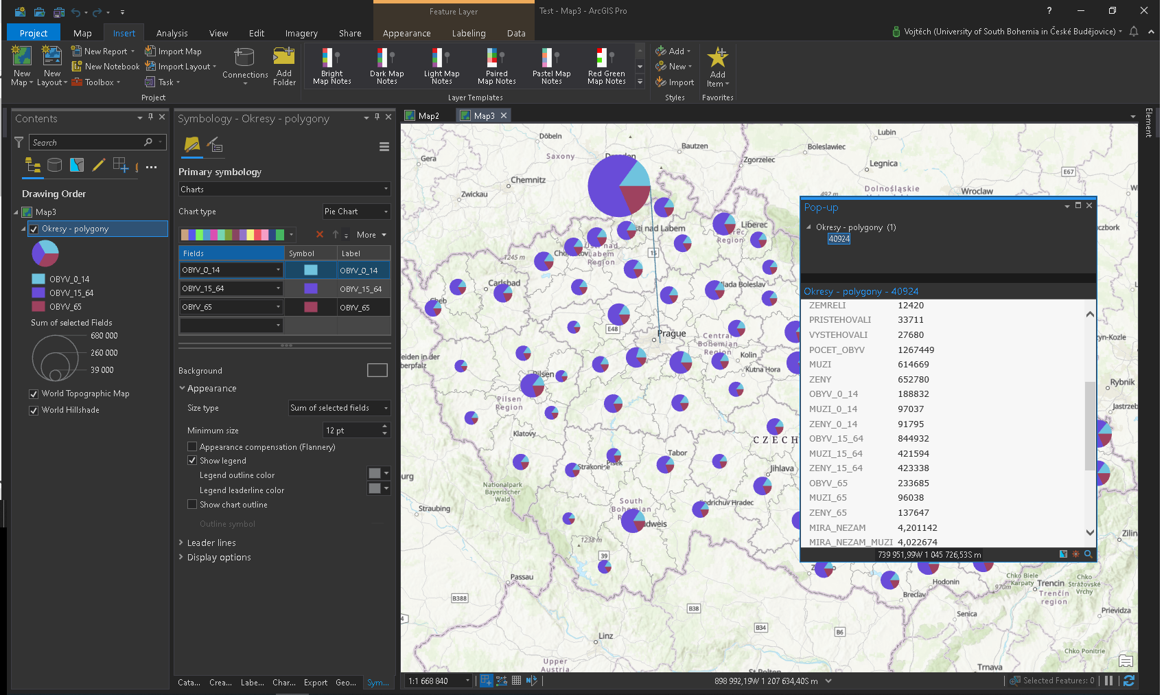

Hello,
It is super that in new version 2.5 is possible to make pie chart symbology.
But the legend generates random values which are not correct. In my case the biggest county has over 1M people, but in legend is shown only 680 000. Its possible to change properities (values) of legend for pie chart?
Thanks
Pie chart symbology problem
Tags (2)
JanBurdziej
Hi, I've noted the same: legend values just don't make sense. In my case the largest value in the data is around 6M, but the pie chart legend shows values up to 56M. There is definitely something wrong with how ArcGIS Pro calculates classes for pie chart legend. Can anyone from Esri look into this, please?
