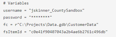

Here is an explanation of the script variables:
  • username = ArcGIS Online username
  • password = ArcGIS Online username password
  • fc = path to feature class used to update feature service
  • fsItemId = the item id of the ArcGIS Online feature service
  • featureService = True if updating a Feature Service, False if updating a Hosted Table
  • hostedTable = True is updating a Hosted Table, False if updating a Feature Service
  • layerIndex = feature service layer index
  • disableSync = True to disable sync, and then re-enable sync after append, False to not disable sync. Set to True if sync is not enabled
  • updateSchema = True will remove/add fields from feature service keeping schema in-sync, False will not remove/add fields
  • upsert = True will not truncate the feature service, requires a field with unique values
  • uniqueField = Field that contains unique values
Note:  For this script to work, the field names in the feature class must match the field names in the hosted feature service.  The hosted feature service can have additional fields, though.

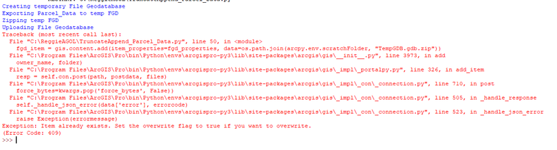

ReggieSanders
Tried moving my service over and getting an error, figured something was configured wrong but ran it on my old machine and it also wasn't working any more.
this is the error
Creating temporary File Geodatabase
Exporting Parcel_Data to temp FGD
Zipping temp FGD
Uploading File Geodatabase
File "C:\ReggieAGOL\TruncateAppend_Parcel_Data.py", line 50, in <module>
fgd_item = gis.content.add(item_properties=fgd_properties, data=os.path.join(arcpy.env.scratchFolder, "TempGDB.gdb.zip"))
File "C:\Program Files\ArcGIS\Pro\bin\Python\envs\arcgispro-py3\lib\site-packages\arcgis\gis\__init__.py", line 3973, in add
owner_name, folder)
File "C:\Program Files\ArcGIS\Pro\bin\Python\envs\arcgispro-py3\lib\site-packages\arcgis\gis\_impl\_portalpy.py", line 326, in add_item
resp = self.con.post(path, postdata, files)
File "C:\Program Files\ArcGIS\Pro\bin\Python\envs\arcgispro-py3\lib\site-packages\arcgis\gis\_impl\_con\_connection.py", line 710, in post
force_bytes=kwargs.pop('force_bytes', False))
File "C:\Program Files\ArcGIS\Pro\bin\Python\envs\arcgispro-py3\lib\site-packages\arcgis\gis\_impl\_con\_connection.py", line 505, in _handle_response
self._handle_json_error(data['error'], errorcode)
File "C:\Program Files\ArcGIS\Pro\bin\Python\envs\arcgispro-py3\lib\site-packages\arcgis\gis\_impl\_con\_connection.py", line 523, in _handle_json_error
raise Exception(errormessage)
Exception: Item already exists. Set the overwrite flag to true if you want to overwrite.
(Error Code: 409)

@KevinMacLeodCAI you would have 2 options:
1.  Overwrite the hosted feature service
2.  Use the script above.  All you have to do is update the 4 variables:
