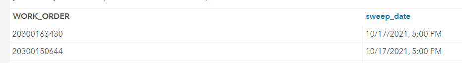

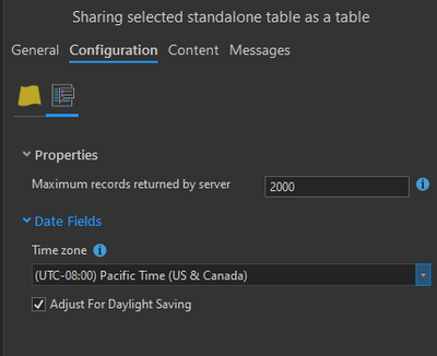

In our case we are using ArcGIS Pro 2.8.x and 10.8.1 Enterprise Portal to publish a hosted feature table, setting the time zone to Pacific Time with daylight savings.
The date/times on the initial table are correct.
However, when we go to append records via Model Builder, they are appending in UTC time, which subtracts 7 or 8 hours from the date and causes the date to shift backwards in time by 1 day.
What can be done Esri? Continuing to troubleshoot on our end but appreciate any help.
