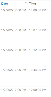

I published a feature layer to AGOL from Pro 2.8.3, and specified the time zone to EST with daylight savings. It publishes correctly, but then when I use the "Append" tool in AGOL, to add data from an excel sheet it accepts the time field correctly. However, the date field converts from EST to UTC  which changes the date to a day earlier.
Excel spreadsheet with correct date
AGOL data with incorrect date
Were you able to find a solution for this?

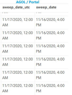

It also depends what environment your viewing the data in.  The two images below are the same published table with two date fields (UTC and local time)
First open in AGOL or Portal the UTC field is correct and the sweep_date (local time) is incorrect.
Second the AGOL / Portal table pulled into ArcPro, now the UTC field is incorrect and the sweep_date (local time) is correct.

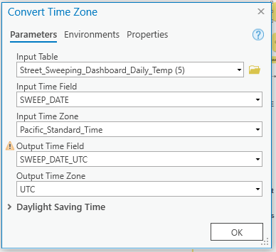

If the data will only be viewed in AGOL / Portal use the "Convert Time Zone" tool to convert the time from local time to UTC.  Then use the Append Tool to add it to the AGOL /  Portal layer
If the data may be used in both AGOL / Portal and ArcPro have two date fields to avoid confusion.
