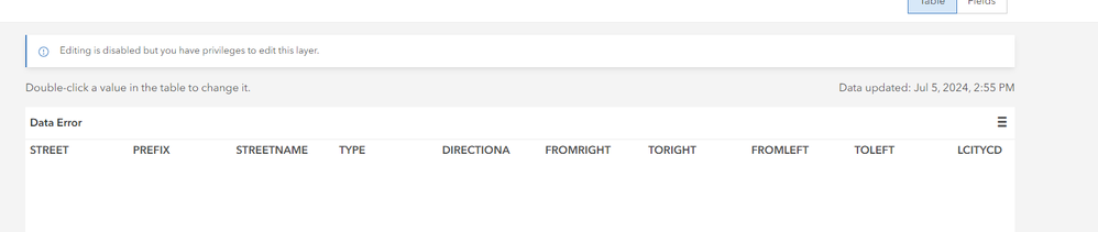

Has anyone had any issues with this since the latest AGOL update? Whenever I try and run it I get an error when trying to view the table data of the layer.AGOLerror.pngAGOLerror.png
