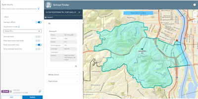

I'm having issues with Zone lookup. When I enter an address in my school finder app, it shows me the elementary school associated with that address, and the middle and high school boundaries as well. The problem I'm having is, when I click on the zoom on the middle and high school boundaries, the map zooms out, but I still only see the elementary school point. I don't see the other schools. I also want users to be able to see ALL the schools and boundaries in the map on search, with the relevant ones highlighted. Right now everything outside the search is hidden. I've toggled off "Hide layers when app loads" and it doesn't seem to have an effect. Is this a bug?   

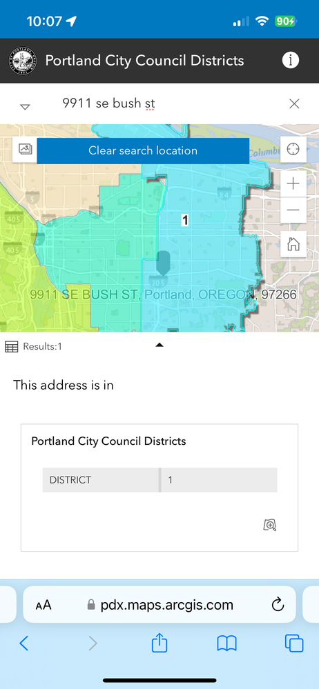

Also the map label for the pin is underneath the layer.  Can you put the label on top?20231012_170739000_iOS.png
PaulCone2
Also, clicking on the map or using the Find my Current Location both return No Result Found, even on mobile.  ???

Having layer effects on doesn't change anything. I have to click "clear search location" to see the other schools around the one in the search. Even though I have "Hide layers when app loads" toggled off. Our enrollment office is asking that parents be able to see the schools in the vicinity of their neighborhood school for transfer purposes. I was able to accomplish this with the District Lookup Widget in WAB, but I have to stop using that now.
Search result:

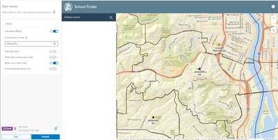

Search result cleared, other schools become visible:
