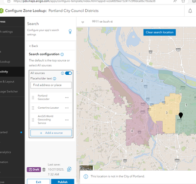

It's very strange -- it's working for me too now, but then on the config map it stopped working.  If you have some time I'd be happy to meet and show you.
PaulCone2
Now it's not working again on three different devices, and I haven't even republished.

I don't think that's the issue. I just tried it on my partner's work computer, which has never browsed to the public page with the app, or AGOL at all, and it also says location not in Portland, even though it clearly is.

All of the above and none of them work.  A pin clearly drops in a polygon, but it returns no results text.

I can reproduce if I use the dev tools to spoof my location as Portland. Now that I can repro i'll dig in and figure out what is going wrong.
KellyHutchins
Esri Notable Contributor
Ok after more testing I found the issue. In some cases the search was happening before the layer was fully loaded causing no results. I have a fix and we'll get it into an Online patch most likely on Monday night. So if all goes well the app will be back to normal Tuesday.
