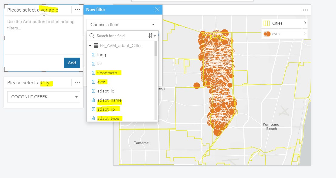

I am trying to create a web app in Insights Desktop such that the app has two drop down menus:
  1. One for variable of interest
  2. Second for location
As you can see I can select the location column in the 2nd drop down since it's a single column. However, I am unable to select multiple columns (each column representing a different variable, 5 columns/5 variables in my case).
If it it was possible to select multiple columns from a drop down menu, then for example, the user would first select the variable of interest let's say `avm`  that would then show `avm` values for different cities depending on the selection from the 2nd drop down menu. Then if the user selected the variable `flood factor` it would filter location values to `flood factor`.
Is it possible to select multiple columns for a drop down menu in Insights desktop? Such an option will save me from creating separate plots for each variable.

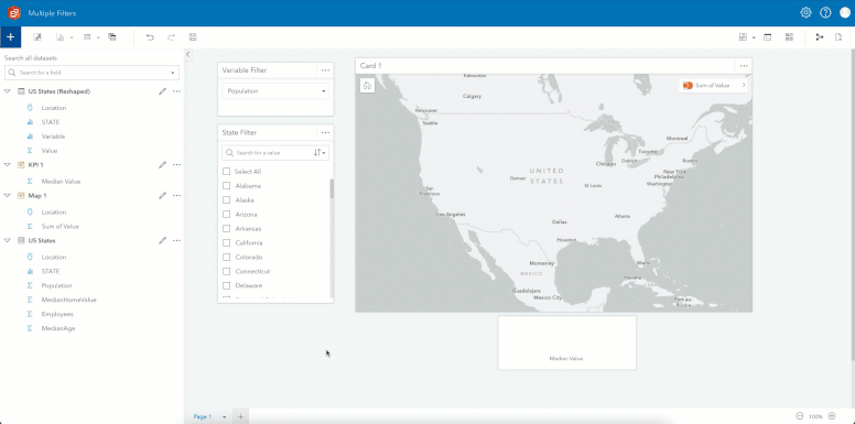

With a big hat tip to @WarrenDavison, here's what I suggest.

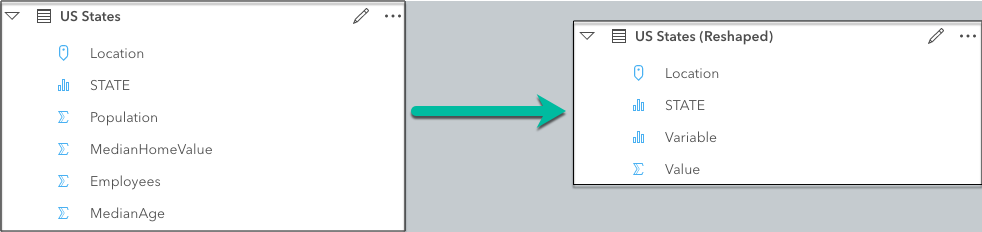

Predefined filters are designed to filter values within a column (i.e., variable) and not the variable itself.  To accomplish this we'll need to reshape the data (in this case wide to tall) so that these variables become string values within the the dataset.
I've taken the following dataset which has 4 variables and transformed from wide to tall.
This allows me to create two Predefined filters:
1. Variable filter (Population, MedianHomeValue, Employees, MedianAge)
2. State filter
This is a fairly simple example but hopefully it illustrates the concept.
@Ed_ will this work for what you're trying to do?

That's correct, you'd want Option 2.  You want to move all three variables (FF, AL-2021, AL-2051) to one column (which you have labeled variable).

My columns of interest for the 1st drop down menu are:
  • Flood Factor
  • avm
  • adapt_type
  • adapt_name
  • adapt_rp

  1. So I want the user to be able to select a variable of interest out of the 5 total variables (5 columns). let's say the user selects `avm` out of the 5 available options from the 1st drop down menu.
  2. Then the user will select the city (`cities` column) from the 2nd drop down menu. Let's say the user selects Coconut Creek.
  3. The app will then filter the map and table to show `avm` values for Coconut Creek.
2. State filter
