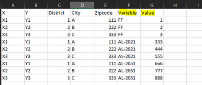

@Scott_Aulen, thank you for the detailed response. So, I need to transform the dataframe to either of the following two right, so which one of these would be the right approach 1or 2?
Cheers,
Question | Analyze | Visualize
Scott_Aulen
That's correct, you'd want Option 2.  You want to move all three variables (FF, AL-2021, AL-2051) to one column (which you have labeled variable).
Ed_
by MVP Regular Contributor
@Scott_Aulen worked like a charm, I had to slightly modify the data as suggested in R. For that I had to use the `pivot_longer` function via `dplyr`. Thanks again.
