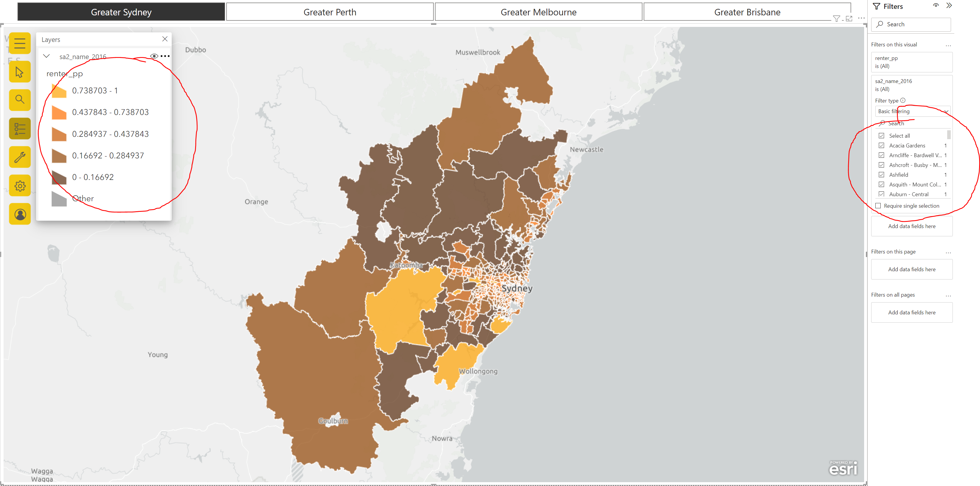

This first screenshot is showing the data filtered by the 'Greater Sydney' slicer value....note the map and legend are based on the full dataset, while the filter is showing the filtered values based on what has been selected in the slicer.

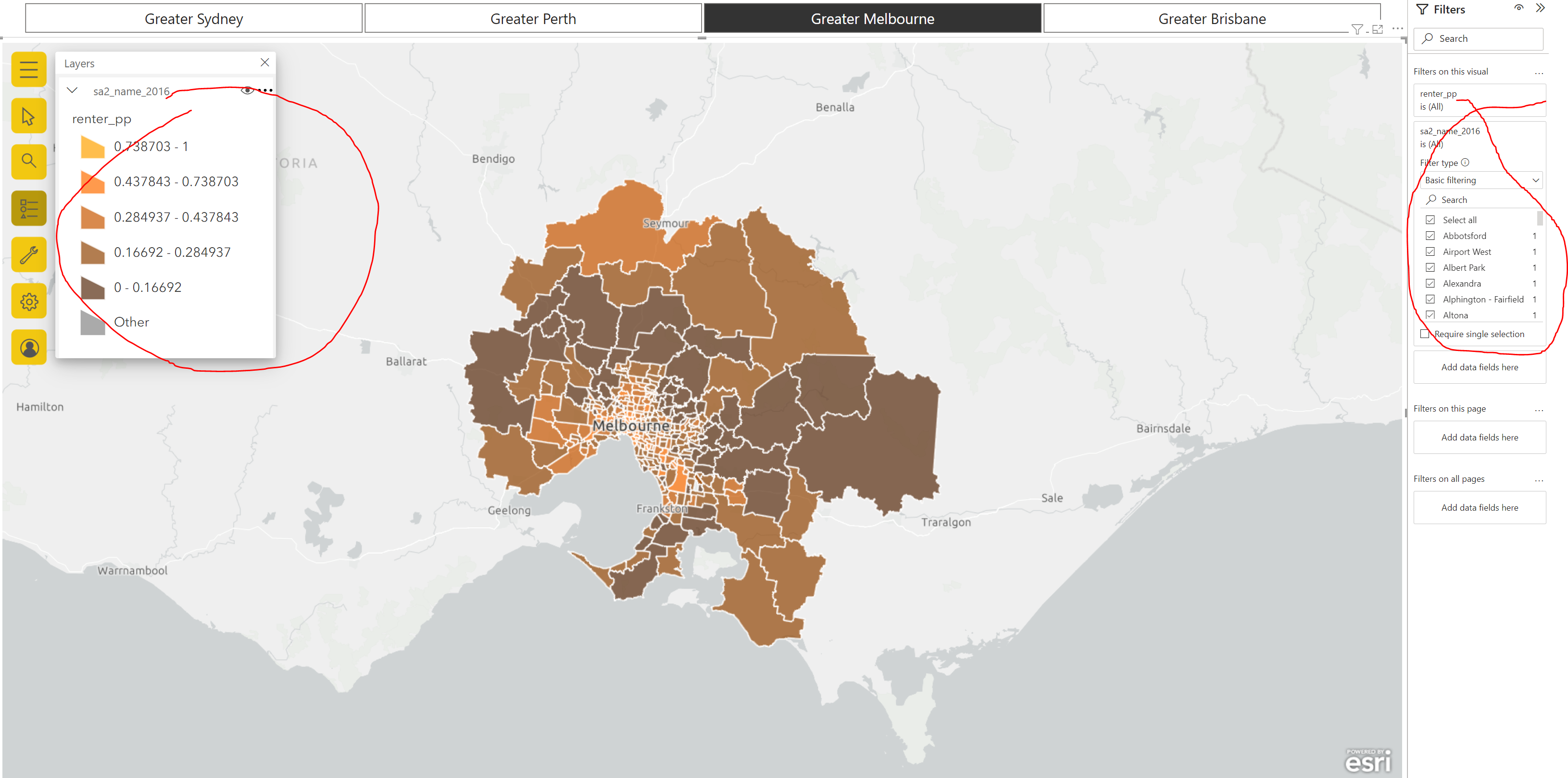

In this second screenshot, after selecting the 'Greater Melbourne' slicer value, the map has zoomed to the correct location and the filter has updated showing the correct values, but the map has not been reclassified - you can see that the legend is still based on the full data set.
Am I missing something? Or is this a limitation or bug?
