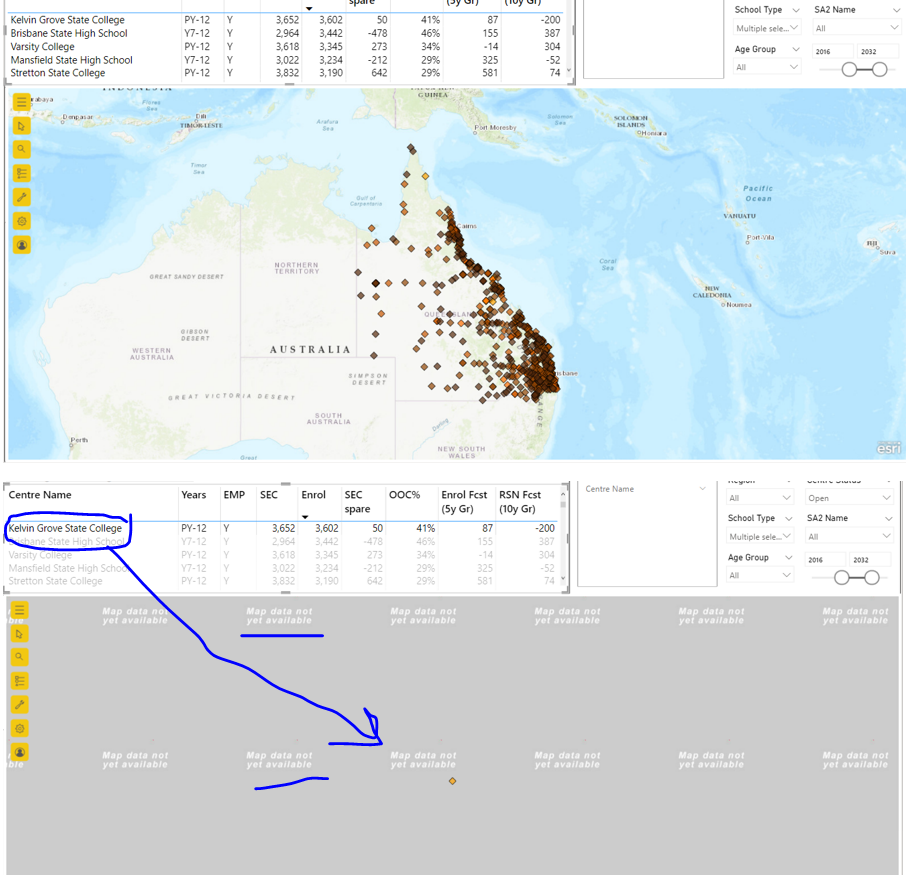

Since the latest update of the ArcGIS maps to Power bi pulgin, I have had issue filtering a single point. The automatic zoom takes it way too close that when I filter or select data for a single point in powerbi. Very annoying  that I have to keep zooming out to show the context of the point.
Any help with this issue would be much appreciated.  Perhaps allowing a zoom level to be set in the extension would help. I don't want to lock the extent.

Thanks, Yeah have tried different base maps and all does the same thing. It previously didn't zoom so close and was really good. I am looking at a school site level so around 1:2000-5000.  I will log this as an idea to be able to set the zoom level.  In the interim it might be better to have it zoom to 1:500-1000, not 1:<100. Even for asset locations this is close enough to differentiate.

@Anonymous User I am experiencing this same behavior on new and older published reports. Tried several basemaps. It happens when selecting a location from a slicer or another visual (table or matrix), but not when clicking on the location within the map or searching on an address/place.

It looks as though this is a bug in our visual. I have used data on my machine and I can reproduce this issue.
I have logged a bug in our project and I will reply to this thread once I know this has been resolved. I apologize in advance for any issues this is causing. Hang tight, we will get it sorted out!
