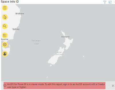

Hi, We are experiencing an issue when loging into ArcGIS for PowerBI with ArcGIS Enterprise. Once logged in with an ArcGIS Enterprise Administrator account into ArcGIS for Power BI we get the following message: "ArcGIS for PowerBI is in viewer mode. To edit this report, sign in to an ArcGIS account with a Creator user type or higher".
Notes:
  • This means we cannot access any of the Enterprise layers, change basemaps, add infographics, etc.
  • That also happens when logging in to PowerBI in the web.
  • It occurs when logged in as a Creator Data Editor and Administrator.
  • We work with ArcGIS Enterprise 10.7.1. which should already be compatible with PowerBI
Can this be resolved through the ArcGIS Enterprise configuration?  I was checking in this page, but I don't know where to find those configurations in ArcGIS Enterprise
Does anyone know how it could be sorted? Many thanks in advance

I wonder if this was resolved? We have the exact same problem when trying to access Enterprise 10.9. The message 'ArcGIS for Power BI is in viewer mode' however the account is a creator user type. No issues for AGOL but just for Enterprise.

That is correct! In the next patch (which should be out soon as @Anonymous User  mentioned), you will no longer see the error when signing into the visual using Enterprise 10.9+.
To give some context, there was a gap between the release of our new/updated visual and the release of Enterprise 10.9. This is why there is an odd error when signing in; it incorrectly states that you are in viewer mode even when you are logged into a creator-type account.
