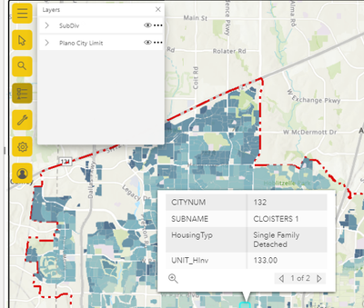

GIS Pop-ups in Power BI:

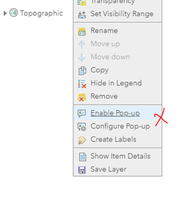

I checked and removed all pop-ups in ArcGIS Online map:

In the screenshot you provided, it looks like you are clicking on a polygon. Is that part of the layer from ArcGIS Online or from the dataset?
As a test, head to the Table of Contents, and hide all of the layers on the map except for the one from ArcGIS Online. Then, attempt to click on the feature and see if the pop-up appears.

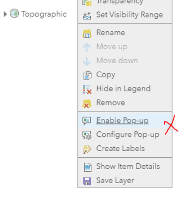

Also, all pop-ups are removed and the map is added in new Power BI.

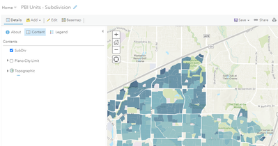

--> Layer in ArcGIS Online with removed pop-ups
After adding this map in Power BI, it comes with Pop-ups that we can not turn it off.

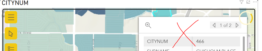

I'm having the same issue. I can turn off pop-ups in the feature layer but when I interact in PBI and hover over a feature I get a generic popup with all of the record's attributes. It also gives me a dock option which just locks the window in the middle of my visual and doesn't give me any ability to edit or move it at all. This completely breaks the functionality of this report.
Another weird issue is that because select (with joined layer) is separate but not mutually exclusive to selecting the base layer, you can end up with two things being visually "selected" on the map by clicking on one with the layer join selection and another automatically selecting because the mouse hovered over it for a few seconds. I'm pretty sure this is the problem that @RezaSardari was having as well: his joined layer wasn't producing the pop-up, it's the default PBI add-in doing that.
You can see this in the attached images. The first is me selecting a polygon from the hosted layer with the pop-ups turned off. Works as expected. The next image is where I hovered over another polygon and the pop-up appeared and cannot be removed. Note that even though the second polygon is highlighted on the map it is not actually selected and has no impact on my report. Is there a way to turn this off in the PBI addon?

@LiamCurrie - Good afternoon! There can be some odd interactions with the Power BI Data layer and a reference layer on the map (whether it be through a Join layer process or just adding it on the map and interacting with it). There have been other instances where pop-ups can be distracting on a report page.
At the moment, we cannot disable the pop-ups on a Power BI data layer. However, we are looking into this feature and exploring ways to enhance it; customization or allowing it to be turned off completely.
