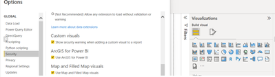

Im tryng to use Arcgis for Power BI but it just wont show the Icon in Visualizations, even if the Arcgis is enable on options. What can I do to use it? Thanks.

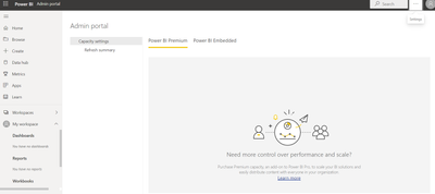

Thank you for your reply @AnthonyLatini. Im using my personal account, there is no other administrator.
I cant find Tenant Settings like in the link you sent:

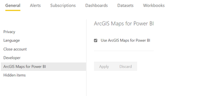

 But I can see that ArcGIS is enable
AnthonyLatini
Thank you for that screenshot @Renatodamasceno ! What version of Power BI Desktop are you currently on? You can find this by clicking on File --> About in Power BI Desktop.
