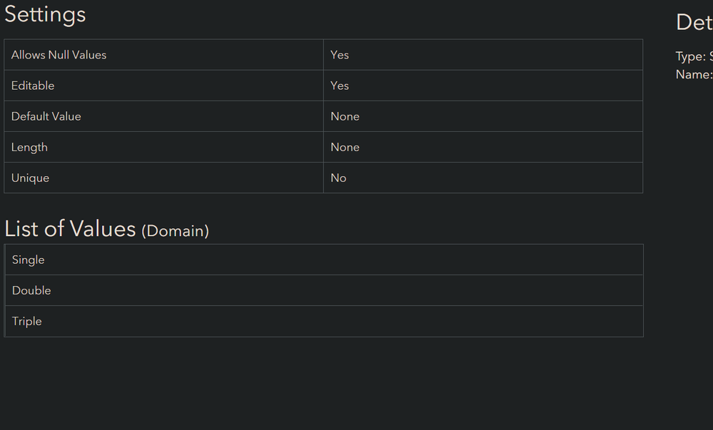

dgiersz_cuyahoga
You probably have to be the Item owner or an administrator.

LLCCG
I think I'm both.

LLCCG
It's hosted in Portal. (It's at myorganization.com/portal/ rather than on Esri's servers, at least, so I assume so.)
That's a screenshot from if I go to "Content", click on the Feature Layer, then go to Data>Fields and then clck the Display Name for the attribute I'm trying to change.

LLCCG
It shows it as a "Feature Layer", but not a "Feature Layer (hosted)". It does show me as the owner, the source is "Feature Service" and url is myorganiztion.com/server/rest/...
