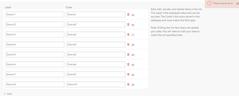

Hello Henry,
I am following your exact steps.  We just upgraded to 10.9.1 and when I try to delete or add an item in the domain I get "there was an error" with no other information.  I have tried it several times with no luck. Any other ideas?
Thank you,

Were you able to resolve this issue?  I am getting the same error when I try to add domain values at 10.9.1.
dgiersz_cuyahoga
Check the request in dev tools and see what the error is, it will be an updateDefinition call.
I just tried to add a value to a domain on our 10.9.1 box and I received an error.
I tried again with the browser dev tools open and looked at the response of the request and it had an error that the description was not a string (it was null in the request).
So I added a description to the field, then tried modifying the domain again and it worked fine.

CassidyKillian
That did the trick.  I added a description to the field and it allowed me to update the domain list.
