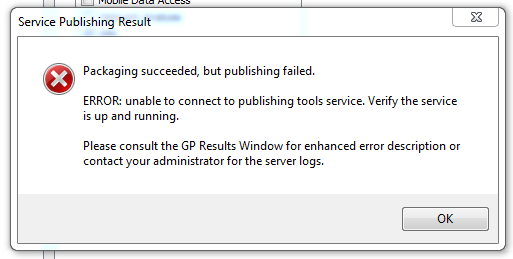

but once I wanted to publish a map service, an error is displayed,when trying to publish a service
I have tried to google the error but none of the tricks helped,
Error: Packaging succeeded, but publishing failed. ERROR: unable to connect to publishing tools serv...  because I've already gone through these stuffs, I don't remeber at all having to create roles in the server manager as that links suggest,

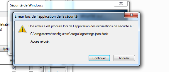

when I tried to give all the permissions to arcgisserver directory,
It displayed that error: (which is about that an error occured while applying the changes. access denied) when I clicked continue it gives the full control to the folder (data-store, directories-logs)
access denied

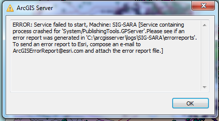

I tried to restart the publishing service but it failed showing that arror:
restarting Publishing service

When you attempted to restart your GP publishing service and got the ArcGIS Server error message, was there a log file in the location specified? c:\arcgisserver\logs\SIG-SARA\errorreports
I suggest you contact Esri Tech Support so they can help look into your issue further.

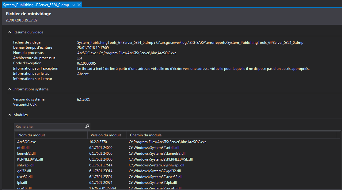

for the  exception information it says: "The thread tried to read from a virtual address or write to a virtual address for which it does not have appropriate access"
