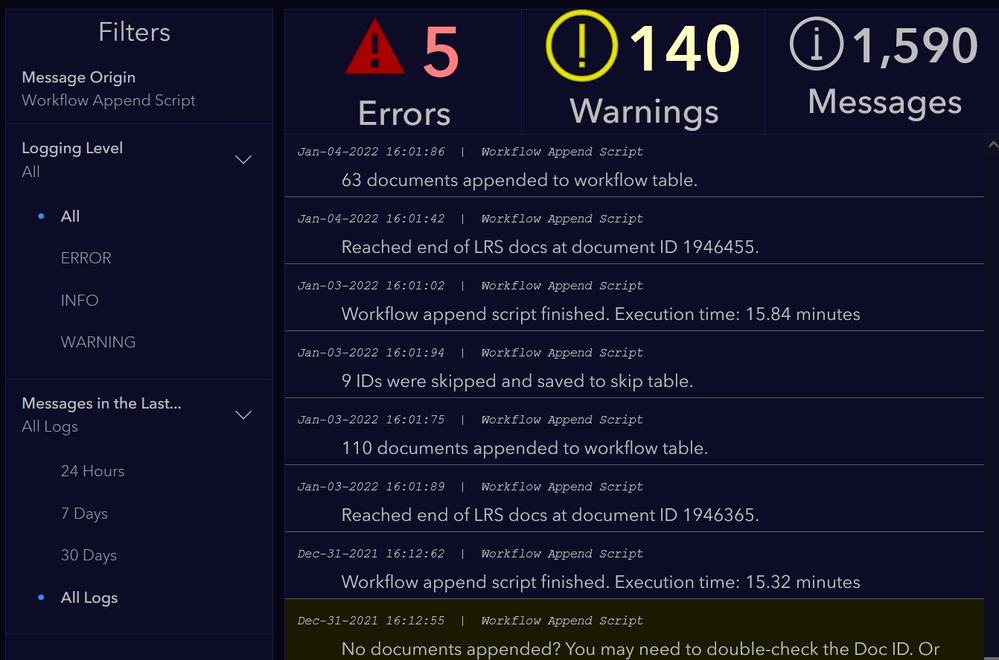

Here at the Esri Midwest User Conference, @DerekLaw gave an excellent session about administering Enterprise, and talked about the different ways to monitor and track your Portal and its services. Really great stuff to know about.
But for you admins out there, there's often another aspect you need to keep track of: custom scripts. If your organization is like mine, you have some repetitive tasks that you've offloaded to some scheduled Python script. You might also have your script running on some other machine than your primary workstation.
Python's built-in logging is great, don't get me wrong. But sometimes, I really just want to get at my logs without having to remote into some other machine or find the log file. You may already have something in place tracking your logs and giving you some kind of notices or warnings. For me, I am always on my Portal when I'm working, and I wanted to leverage the tools I already had.
So I built a Dashboard. Well, and some other things. This project relies on three key parts:
  1. A hosted table
  2. A dashboard
  3. A custom python function (though this one's optional)
The End Product
Last things first, let me just show you the end product. If you like the idea, then feel free to read the rest of this to make your own.
I have an admin-only dashboard that shows me recent logs generated by my scripts. I can use Dashboard's tools to quickly filter the dashboard by message origin, log level, and predefined time ranges. I use features like Advanced Formatting in my List and Conditional Formatting in my indicators to give me a quick, at-a-glance overview of what's going on with my scheduled Python scripts, all in a dashboard simple enough to easily embed elsewhere.
If you like this idea, copy it! Here's how:

The Dashboard
The dashboard portion of this is pretty simple. You could probably figure it all out from the screenshot above. Just connect to your log layer in a new dashboard and create a List. I'm on Enterprise, so I don't get those fancy Table widgets yet, but you AGOL users, go for it!

Once you have your list, then you just need some filters so that you can quickly zero in on the logs you want. That's pretty standard Dashboard work, so I won't bother elaborating on it here.
And that's it! Now you've got one central location for all your script logs, and you can access it from any device!

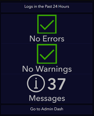

If you want to take things a step further, you can make a mini-version of the dashboard for viewing on mobile, or for embedding elsewhere.
Include a handy link to the full dashboard, and you can get into the logs if you see anything pop up that needs attention.
