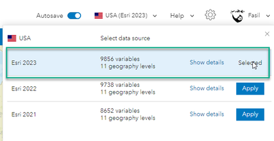

3. Notice the Esri 2023 is now the default vintage. If that is not the case, please select it from the data source selection option.

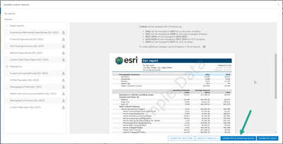

6. After the migration, you will see all your custom reports and infographics that require label updating. Click Update this & remaining reports button to update all labels at once.
Update custom reports

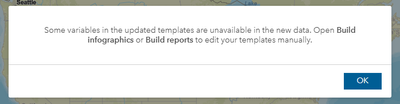

8. When the process is complete, you will see this final message. Your migrated/updated templates might contain variables that are no longer available in the Esri 2023 vintage. If that is the case, you will have to manually edit and update your templates.

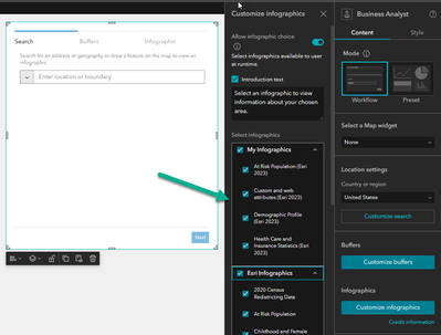

9. If you go to the Build Reports or Build Infographics workflows, you will see your templates are now migrated and contain (Esri 2023) in the names.
My templates gallery
10. You can now go back to your Business Analyst widgets in Experience Builder or Web AppBuilder and simply refresh to see your updated custom infographics and reports.
My infographics list in ExB
11. Going forward, just make sure to select the Esri 2023 data source before creating any custom infographics and reports so that your templates are automatically available in the Business Analyst widgets for Web AppBuilder and Experience Builder.

In most use cases, you will not have to do any additional manual updates when your templates contain variables from custom data. You should be able to continue using the migrated 2023 templates unless there were specific variables that are no longer available in the updated 2023 vintage. In this case, you might see this message after the migration and update is complete.
Then you can open your custom templates and spot check for missing variables. Your custom data variables should be in the updated templates and they can be used in BA widgets (ExB or WAB) without any additional manual updating.

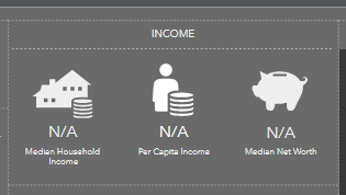

More details will help us troubleshoot the issue you're reporting as Helen mentioned above. For example, are you using the BA widget in Web AppBuilder or Experience Builder? If you are using Experience Builder, I suspect the error you are seeing might be one of these:
Your infographic does not load and show this error
Your infographic loads but shows all N/A values

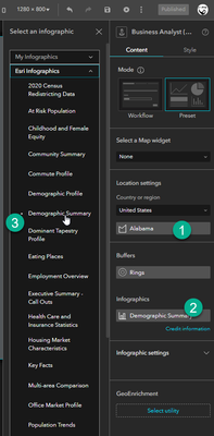

If that is the case, these errors might be related to the data update and geography boundary changes. If you have an app created before the 2023 data update, please follow these steps to update your app configuration:
Step 1. If you have a geography as a preset location, please remove and add it again.
Step 2 and 3. If you have a preset Esri Infographic, please click it (2) and re-select it from the list (3)
Step 4. Save and publish your app.
