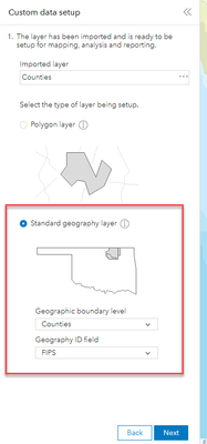

Due to these geography differences when using 2023, your custom data lists are filtered out if they are configured as Standard geography layer as shown below:

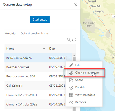

  2. Open your custom data list and open the action menu next to it (3 dots)
  3. Click Change layer type > select Polygon layer > Next > Save FasilTiru_1-1687211856663.png

  6. Click Change layer type > select Standard geography layer and match the expected geography fields > Next > Save
