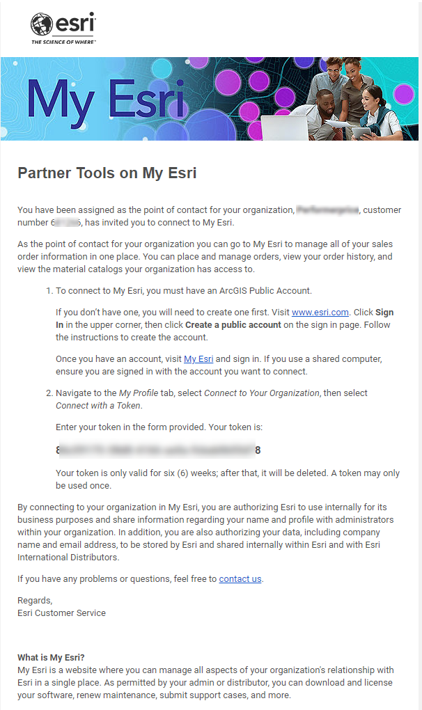

Within 3-7 days of receiving your email, 'Welcome to the Program', the team member that applied will receive 3 critical software emails from the following senders, Service (service@esri.com), Esri, and My Esri (no-reply@esri.com):
- My Esri, provides instructions for the primary contact to connect to your organization and customer number within My Esri using a token. Admin needs to invite staff (users) and delegate permissions to access software or tech support.

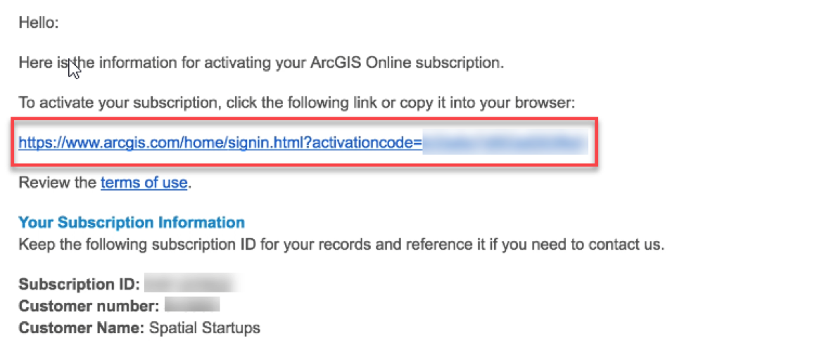

- Esri – Activate Your ArcGIS Online Subscription, contains an activation link for your new commercial ArcGIS Online Organization, with numerous user types and 10k credits - including add-on apps like ArcGIS Pro, Configurable Apps, and more. This should be used as your primary commercial staging for the production subscription account (unless you plan to only deploy an app using ArcGIS Location Platform pay-as-you-go services consumption pricing via API Key and the dashboard).

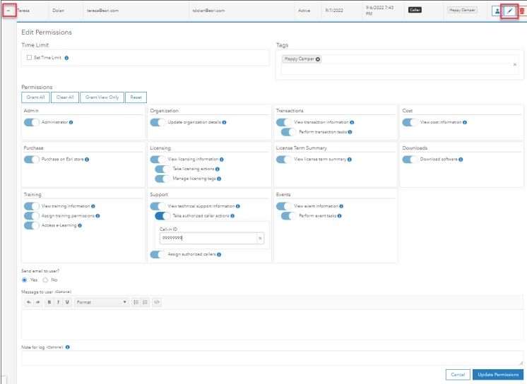

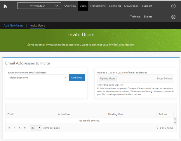

2. Invite your Team Members & update permissions: Go to “My Organizations” -> ”Users” -> “Invite Users” and follow the instructions. Here you can add multiple users by email, configure their permissions, and annotate the invitation. Be sure to activate
*Note, we recommend your team members create an ArcGIS Username login dedicated to your company to avoid confusion. Issues? Sign out of previous accounts and restart the browser.
Update Permissions: Be sure to enable the proper permissions, such as access to tech support. in order for a team member to log a case with Support, they must be registered as an authorized caller.

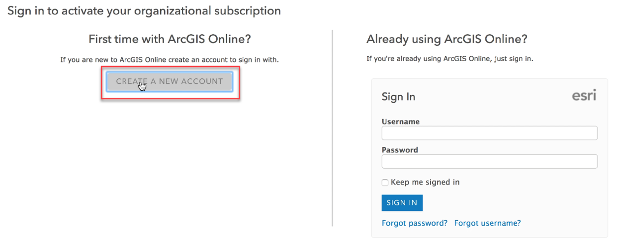

- Activate the Organization: In the ArcGIS Online email, first, click the link then create a NEW account and follow the instructions. This creates the ArcGIS Online account.

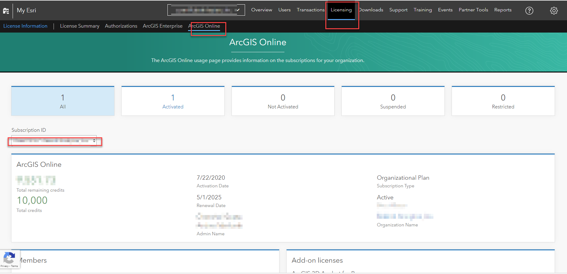

- View ArcGIS Online Subscription Info in My Esri: "Organization"-> "Liscensing"-> ArcGIS Online" but Manage ArcGIS Online via www.arcgis.com.
