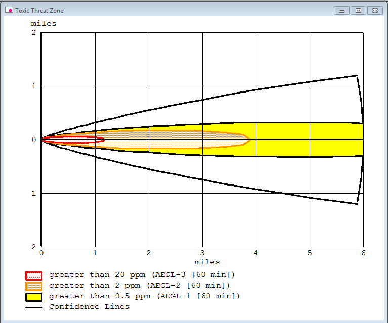

Quick question Robert...I created my own PAS file and added it to your test site as well as my own Aloha test site with a measure tool added.  It seems that there is a difference in the scale between what Aloha gives in its chart and what the tool displays on screen.  In my example my chart maxed out at 6 miles.  When I added the PAS file to the widget in either website it came out at 4.5 miles.  I added the PAS file in the same location in your preview site as I did in our test site to make sure they appeared the same size.  We also measured the length in ArcGIS to make sure there was not a measurement tool issue.
Any ideas?  I originally thought we needed our data in a specific projection, but both of our sites do not utilize any other data but the ESRI basemap.

   So you are saying that the measurement should be 6 miles and it is 4.5? Can you zip your pas and attach it?
NicholasBarger
Yes...when I look at the image in Aloha it stopped the chart at 6 miles.  So, the of the PAS image should be 6 miles in an app but it ends up 4.5 miles.  This is the test.pas file.  The other one I have attached test2.pas should be about 5.5 mile based on the Aloha image but ends up around 4.2 miles.  What I found was the image appears to be about 33% smaller than the image shown in Aloha.
Here is a picture from a test app that I created with no other layers except the ESRI Basemap.

   I see the issue and should have it fixed today.

Hi Robert,
I just got around to the Aloha Widget and everything appears to be working correctly.  Thanks again!
