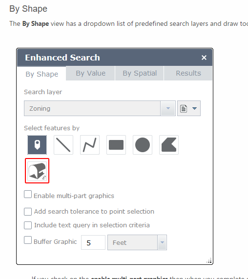

I'm currently deploying the Enhanced Search widget in a developer version of Web App Builder and am having some trouble getting the functionality I need.
I have a layer of polygons (area boundaries) and a set of points (crash locations). I need users to select all the crashes that occur in a specific area polygon. Currently I can select the polygon (select by value), and I can select crashes that occur in a hand-drawn extent (select by shape), but I can't combine the two to say 'select the crashes that are inside the selected polygon'.
Looking at the help doc here​ I can see that it should be possible. The symbol outlined in red should be coming up.. but it's not. Yes, in the 'Edit Graphical Search Options' link I have checked the 'eLocate Widget Graphics' checkbox.
I feel like I'm missing something very obvious... any suggestions? I'm using the latest version of both WAB and the eSearch widget.

Natalie,
The workflow you would use is to select the polygon area "by value" and then click the "by Spatial" tab and choose your crashes layer from the dropdown there, and then the "entirely contained in" or "intersected by" buttons.

NatalieScott4
Thanks Robert, I knew the functionality would be there somewhere. I appreciate your widgets, they make life much easier!
