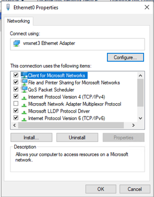

Hi Jeff,
Unfortunately, the workarounds mentioned in this bug are not helpful in my case as my windows server 2022 has already ipv6 enabled. I even tried to add the disabledcomponents registry without any good result.
I am recieving exactly the same error message which mentioned in the bug
Error:
ERROR 999999: Something unexpected caused the tool to fail. Contact Esri Technical Support (http://esriurl.com/support) to Report a Bug, and refer to the error help for potential solutions or workarounds. Invalid url: blocked host. Failed to execute (Publish Portal Service). Failed.
Thanks in advance
it applies now on 11.4 - windows server 2022 (with the latest patches)
Here is a screenshot from my network adaptor
//Anas

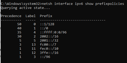

I then followed this Microsoft documentation to verify if IPv4 was being preferred. The "netsh interface ipv6 show prefixpolicies" command indicated that the '::ffff:0:0/96' prefix did not have a higher precedence than the '::/0' prefix.
netsh resultsnetsh results

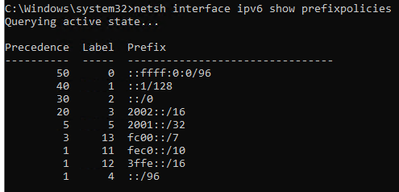

 After setting the prefixpolicies, I ran "netsh interface ipv6 show prefixpolicies" to verify that the changes had taken effect.
After confirming that IPv4 was indeed being prioritized, I restarted Server in services and was able to publish to a hosted feature layer from an uploaded shapefile without issue.
