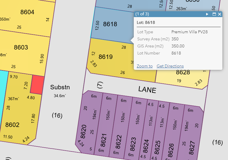

This is an example of the end result using a mix of polygons shared as vector features and annotation as a map image.

We share the same issue - I use the same workflow as you mentioned above: converting the annotations to GDB first, then publishing them as MapImage or Tile (Copy all data). The performance although is not like in the CAD files, some annotations are differently positioned, not mentioning the size and the font of the annotations are also something else.
