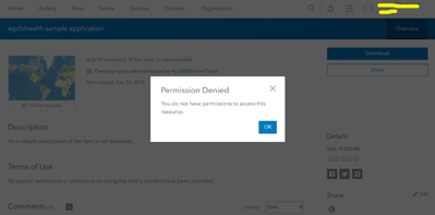

Hello, I am attempting to download the egdbhealth from the below-mentioned link, but I was unable to do so even after using multiple logins. I am attaching the error below; can anyone assist me in resolving this issue?
link: https://arcgismonitor.maps.arcgis.com/home/item.html?id=f343f6b2bbcf434386f6dde1e468e7ab
DannyKrouk1
New Explorer
I'm sorry about the problem. I suffer the same problem myself. I'll contact the owner of the ArcGIS Monitor account and ask them to look into it. - Danny
DannyKrouk
I believe the download link issues have been resolved.

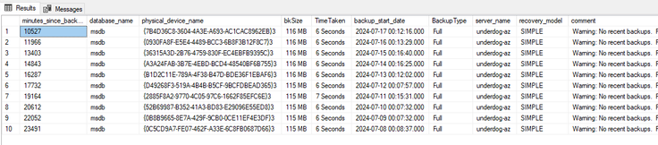

@SGTomlins If you would, please run the SQL statement against your system in SSMS and show me a screen capture of the result in an email ([email protected]).  Thank you. 🙂
SGTomlins
Here ya go @DannyKrouk ...  Ran it this morning.
-Steve
DannyKrouk
@SGTomlins  Thanks.  The query is seeing your backups.  That's good.
From appearances, the default definition of "recent" for the egdbhealth query is out of alignment with your default definition of recent.  It sees your back-ups.  They are all from a week or more ago.  If you run this tool right after you run take your backup, the results should be different.
Do you see another interpretation of this data?

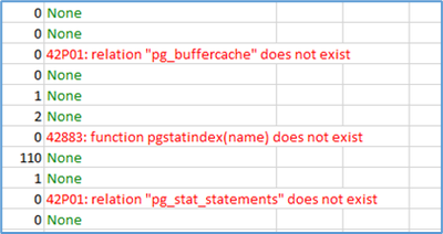

Was able to run it via the UI, got some errors, not as many as I expected.
aurora-postgresql 15.6
The geodatabase is a read only copy that gets refreshed nightly
Just ran it without enabling the additional modules and got the expected errors. As well as not running as superuser - will get those changes made and see if it comes back error free.
On excel expert 19 errors on 108 queries and most are due to conifg for the tool
  • 9 permission - login is not superuser
  • 4 related to modules not loaded
  • 3 for relation: sde_geometry_columns does not exist
  • 2 for versioning - sde_log_compress does not exist
