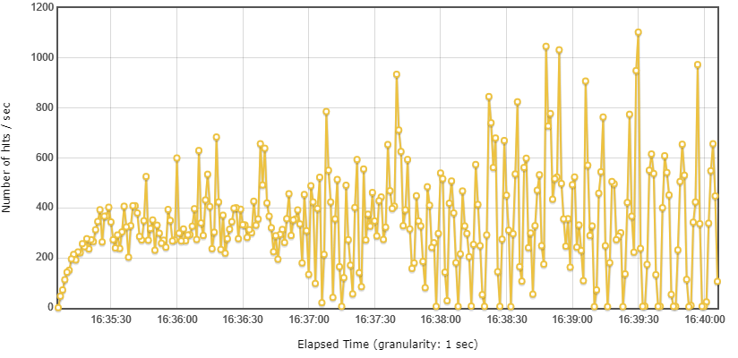

ChiefKeefSosa300
Hi @AaronLopez , thanks for lengthy explanation regarding the test. However,
Im using your test plan to test my arcgis portal but using different map service, the result of the graph is like this (100 users for 5 minutes), is this acceptable result? seems weird and different from yours.
Hits per secHits per sec
time vs threadstime vs threads
AaronLopez
Hi @ChiefKeefSosa300,
It depends. You stated you tested a different map service. Does that mean different data than natural
earth?
If yes, each dataset will have its own profile for performance and scalability because the geometry density and complexity can vary. Your data may have more (or less) layers and each layer may have more (or less) attributes.
If no, and you also tested natural earth, then there is a greater chance of seeing a similar profile for performance/scalability, but there are still other variables which can impact response time and throughput like the system architecture (number of machines) and hardware (number of CPUs, CPU speed and memory).
Hope this helps.
Aaron
ChiefKeefSosa300
Hi sir @AaronLopez,
I think i made wrong kind of test because i use the same datasets (project folder) for natural earth but the service name and webserver name is different.
I checked the csv file for each datasets and the home column said "eistsrv05.esri.com_443__Natural_Earth_quick_start_for_ArcMap" so yeah i guess the test result is invalid. But can it be done like this? Use the same datasets for natural earth but different map service? if not how can one acquire its own datasets. Thank you
