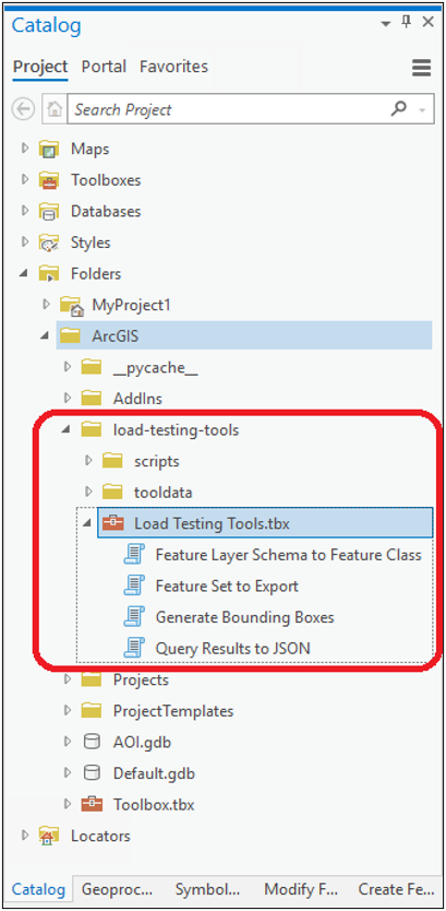

Once the load-testing-tools project has been downloaded to your machine, place the folder in a directory that is accessible or made accessible by ArcGIS Pro.
For example:
  • Place the load-testing-tools folder in C:\Users\[username]\Documents\ArcGIS
  • Use the Add Folder Connection from Catalog in ArcGIS Pro to list the contents of this directory:

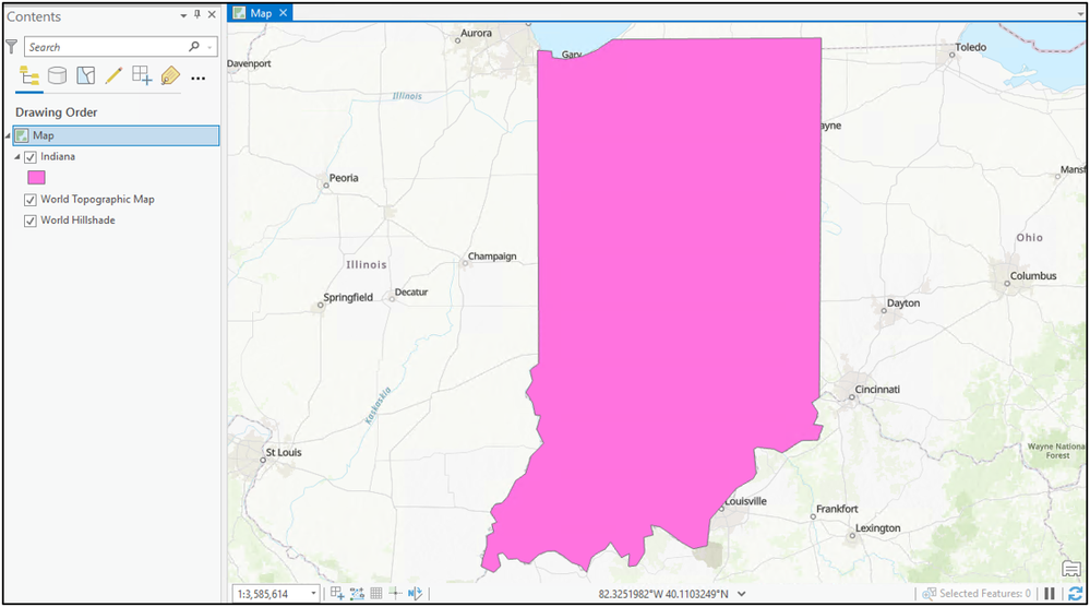

Using A Polygon to Outline the Area of Interest
In this ArcGIS Pro project, a polygon feature class (U.S. State of Indiana in pink) has been added to the Map to define a boundary around the area where the bounding boxes for the requests in the test will be generated.
  • The Projected Coordinate System of the Indiana State feature class is: WGS 1984 Web Mercator (auxiliary sphere)
    • Its WKID is: 3857
  • For a point of reference, the default Basemap (World Topographic Map) is left in the map
    • The Projected Coordinate System of the Basemap is also: WGS 1984 Web Mercator (auxiliary sphere)

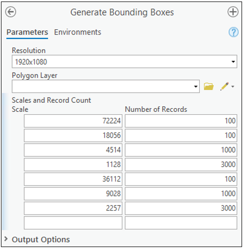

Generate Bounding Boxes Tool Inputs
You can launch the Generate Bounding Boxes tool, by navigating the load-testing-tools folder from the ArcGIS Pro Catalog screen. Expand the Load Testing Tools.tbx and double-click on Generate Bounding Boxes. The Geoprocessing screen should populate and look similar to the following:

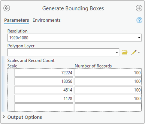

One of the convenient features about the Generate Bounding Boxes tool is that technically ready to go just by clicking Run! With the default options, it will randomly generate bounding boxes using the current extent of the ArcGIS Pro map.

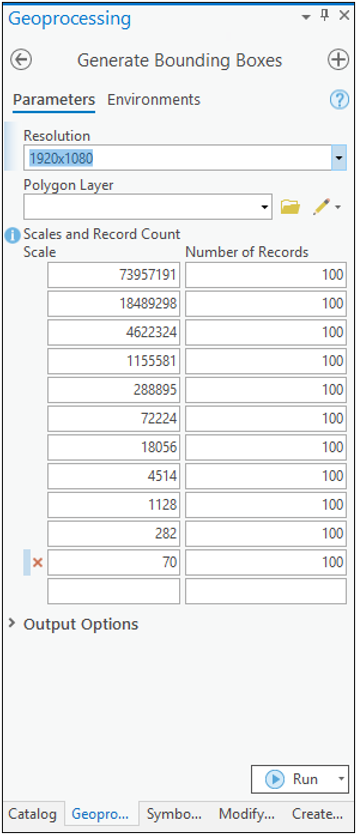

Note: The default map scales of the Generate Bounding Boxes tool are similar to those of ArcGIS Online but for brevity, only every other scale is listed. You additional map scales are needed, they can be manually added from within the tool.
While this make the data generation really easy, in this example, we are interested in generating boxes inside a particular polygon (State of Indiana). We also want to be very specific on the map scales our test will be using, so we'll want to remove some scales and add others from the tool's interface.
From the Generate Bounding Boxes tool:
  • Click the red X in front of 73957191, 18489298, 4622324, 1155581, 288895, 282, 70 to remove these map scales
  • From the empty text box under the Scale column, Add 36112 and use 100 for the Number of Records column
  • From the empty text box under the Scale column, Add 9028 and use 1000 for the Number of Records column
  • From the empty text box under the Scale column, Add 2257 and use 3000 for the Number of Records column
  • Increase the Number of Records for 4514 to 1000 records
  • Increase the Number of Records for 1128 to 3000 records

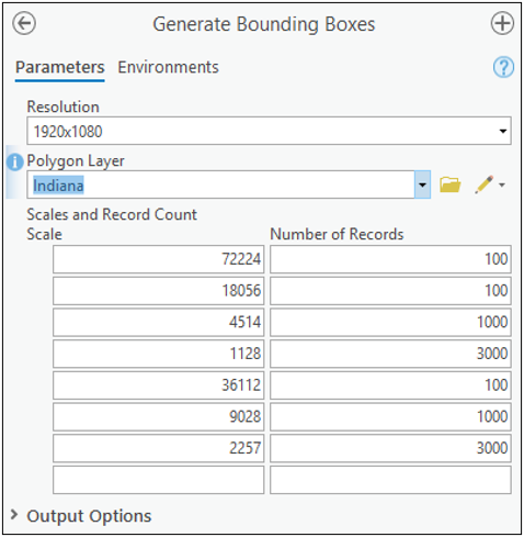

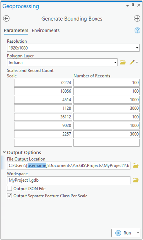

  •  Click the drop down under Polygon Layer and select the feature class of interest with in the Map, in this case, Indiana

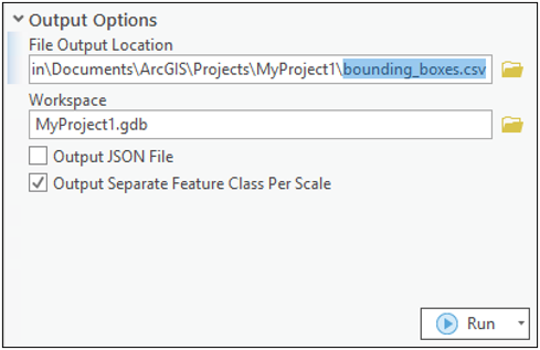

  •  Expand Output Options
    • Note the location of the bounding boxes csv file
      • Separate csv files per map scale will also be created at this location
    • Select "Output Separate Feature Class Per Scale" option
  • After the customization, the Generate Bounding Boxes tool input should look like the following ([username] would reflect your Windows username):
  • Click Run

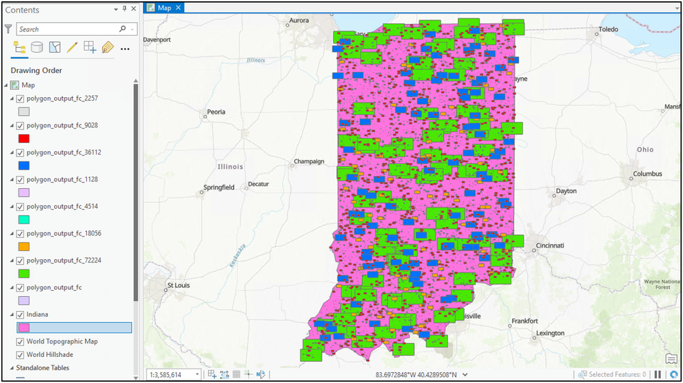

Visualizing the Generated Data from the Individual Feature Classes
  • Once complete, the output within ArcGIS Pro should look similar to the following:
  • The individual feature class make quality checking a breeze as its easy to see the areas of interest that the test will be making from the generated data
Note: Some of the generated bounding boxes may have portions of the their geometry that fall outside the polygon of interest. This is okay.
  • Thanks to the visualization of the data, it is also easy to see why fewer bounding boxes were created for smaller map scales like 1:72,224 and 1:36,112
  • Similarly, this is why more bounding boxes were created for larger map scales like 1:2,257 and 1:1,128
 Note: Depending on your data and it density at the larger scales, it could be advantageous to generate more than 3000 bounding boxes (per scale) in order to "cover more ground". Keep in mind that some load test frameworks may read CSV data into memory and creating extremely large datasets may require more memory from the test client.

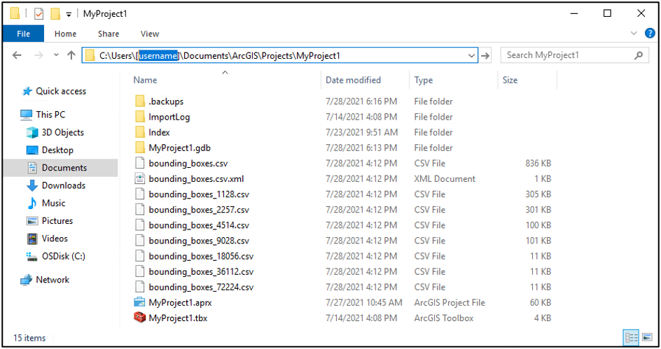

Visualizing the Generated Data from the Individual CSV Files
  • Using the file system explorer, navigate to the ArcGIS Pro project used for generating the data:
    • C:\Users\[username]\Documents\ArcGIS\Projects\MyProject1
  • The folder contents should look similar to the following:

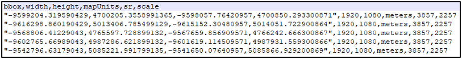

  • Opening the contents of bounding_boxes_2257.csv should resemble the following:
  • This data will work with most load testing tools that allow the parameterization of HTTP requests from CSV files
Note: The feature class to use as a Polygon Layer for spatial filtering can utilize a Projected Coordinate Systems other than WGS 1984 Web Mercator (auxiliary sphere). However, the generated CSV data will still be projected into bounding boxes that have a WKID of 3857.

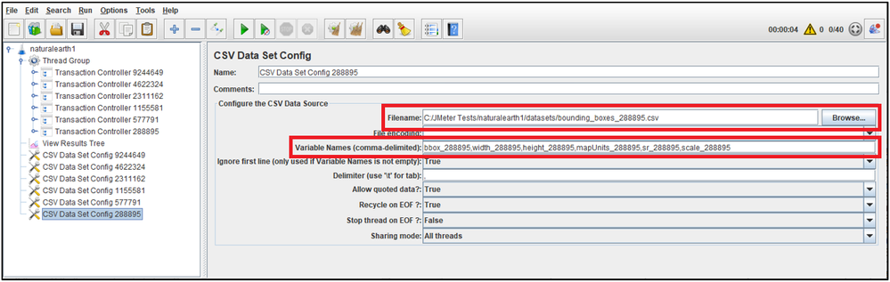

Using the Generated Data in an Apache JMeter Test Plan
With a procedure for generating spatially customized data, you can take the CSV files and import them into an Apache JMeter Test Plan to use in a load test.
The previous testing Articles:
Provided Apache JMeter sample tests that would make good templates to use with your new data and against your map services.
CSV Data Set Config
Using the CSV Data Set Config element in JMeter, the new generated test data can be referenced from its path on the file system.
  • The Filename path value refers to the location of the CSV file on the disk
    • C:/JMeter Tests/naturalearth1/datasets/bounding_boxes_288895.csv
      • Sample test projects from previous Articles used variables for the path
        • ${ProjectFolder}/datasets/bounding_boxes_288895.csv
  • The Variable Names denotes the column headers in the CSV file
    • bbox,width,height,mapUnits,sr,scale would then become bbox_288895,width_288895,height_288895,mapUnits_288895,sr_288895,scale_288895 as the test may be using other map scales where just "bbox" would be ambiguous
The HTTP Request elements pointing to your map service can then be adjusted to utilize variables such as ${bbox_288895} that reference your generated test data.
