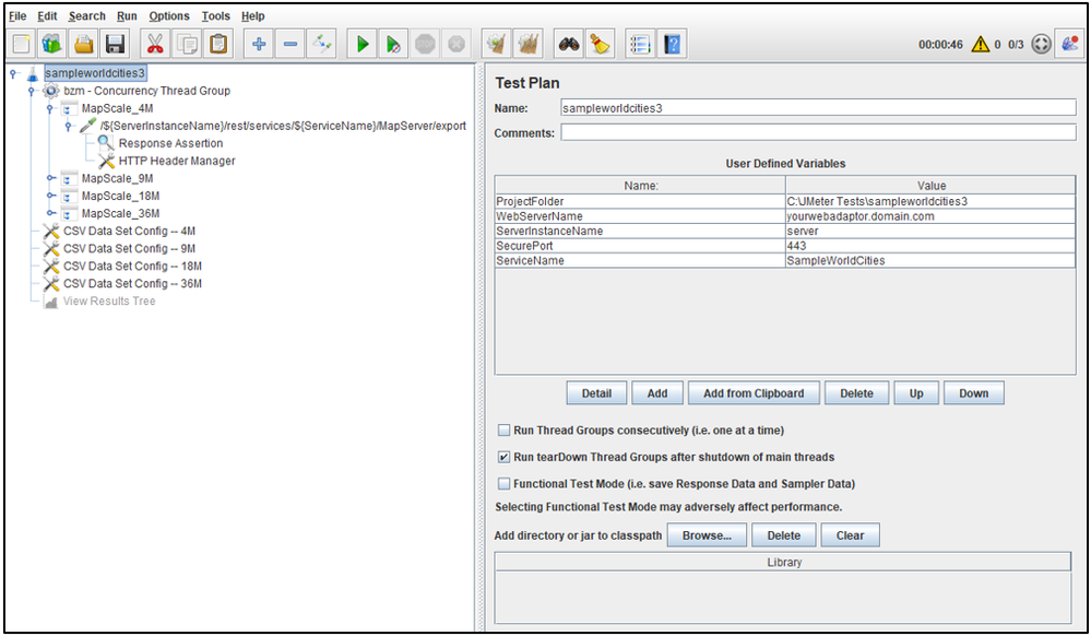

For simplicity, this Article will be building directly off the Test Plan used from Running an Apache JMeter Load Test from Command-line mode (Beginner/Intermediate) called sampleworldcities3.zip
This Test Plan dynamically applied load to a publicly accessible ArcGIS Enterprise service called SampleWorldCities across four different map scales, each of which were an HTTP Request put into its own Transaction Controller. Many of the components of the test (e.g. Project Folder, Web Server Name, Service Name) were conveniently put into variables to make sharing and portability easy.
Creating the sampleworldcities4 Test Plan
Simply put, sampleworldcities4 is based directly on the Test Plan of sampleworldcities3

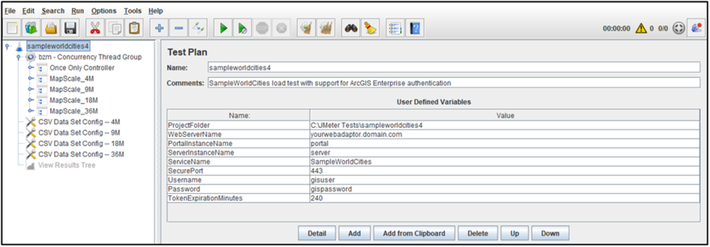

User Defined Variables
Add additional User Defined Variables:
  • Click on the Test Plan (e.g. sampleworldcities4)
    • By default, this should be selected when a new Test Plan is opened
  • At the bottom of the User Defined Variables Section, click Add
    • For Name enter: Username
      • For Value enter: username
        • Enter a username of a member within the portal that has been authorized to consume the SampleWorldCities map service
        • If the user is a domain member, enter domain\username
    • For Name enter: Password
      • For Value enter: password
        • Enter the password associated with the username above
    • For Name enter: TokenExpirationMinutes
      • For Value enter: 240
        • This will generate tokens with a 4 hour expiration
        • This can be adjusted as needed, but a typical test does not exceed this duration
Note: Once the Test Plan is saved, Apache JMeter stores the username and password in plain text within the JMX file
Rename the value for the ProjectFolder User Defined Variable
  • Rename the Value contents from: C:\JMeter Tests\sampleworldcities3
    • To: C:\JMeter Tests\sampleworldcities4
      • If Test Plan resides in another location, please adjust as needed
Rename the values for the WebServerName, PortalInstanceName, and ServerInstanceName User Defined Variables
  • Rename the Value contents as needed

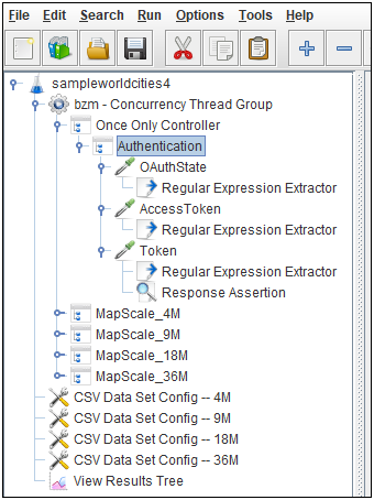

Authentication Requests to Acquire a Token
When you authenticate to an ArcGIS Enterprise Site from a web browser with a typical JavaScript application using built-in or domain member credentials there are several items sent back and forth from the client to the server in the process. These items appear in several HTTP requests and responses. While this traffic is made of many requests, the majority of them are calls for static content that are only needed for presentation (within the browser). The core authentication pieces, captured by logging into the REST endpoint of a deployment , are from three requests:
  • OAuthState
  • AccessToken
  • Token
In the Test Plan, these three HTTP requests will be put into one Transaction Controller that make up the authentication logic. Additionally, Regular Expression Extractors will be used for each request to pull out specific information from the server's responses. Lastly, this will all be put into another logical container called the Once Only Controller. This becomes the first item in the test. As the name implies, anything grouped into this controller is executed only once per the lifetime of the test thread.

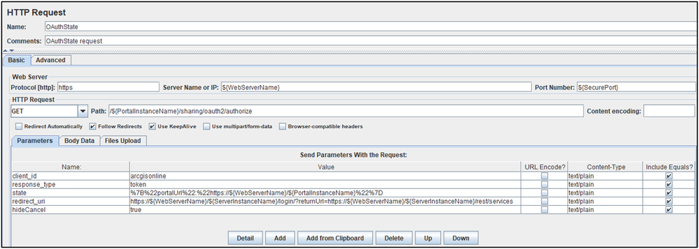

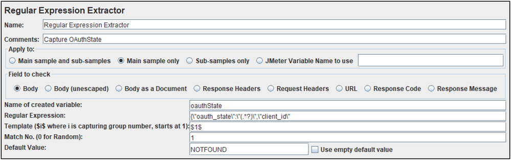

OAuthState HTTP Request
Responsible for generating an OAuthState response (implicit grant) from the server.
OAuthState Regular Expression Extractor
Used to capture the state into a variable called: oauthState

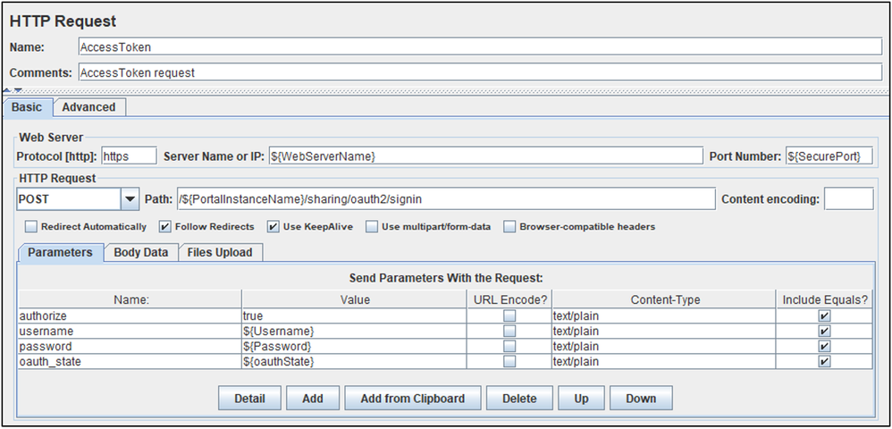

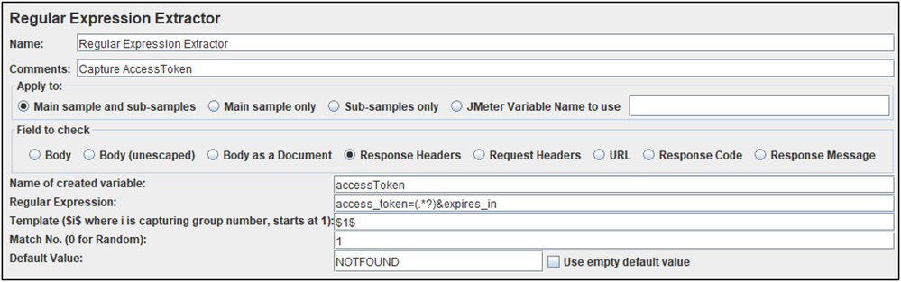

AccessToken HTTP Request
Responsible for passing in the credentials and oauth_state variables. If valid, these will generate the an AccessToken response from the server
AccessToken Regular Expression Extractor
Used to capture the item into a variable called: accessToken

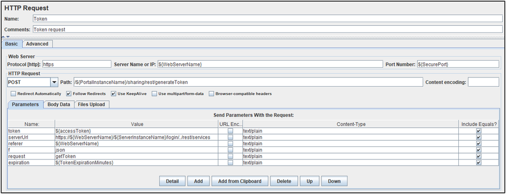

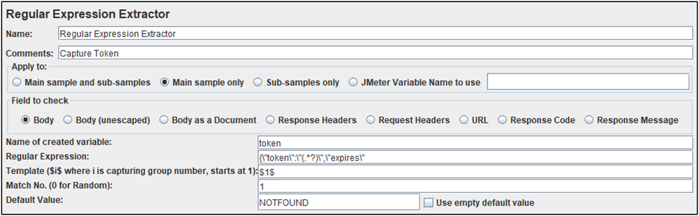

Token HTTP Request
Responsible for generating a token from the server.
Used to capture the item in a variable called: token
This variable is passed as an HTTP header to authenticate each request against the secured service.

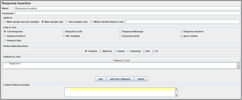

Token Response Assertion
Added to the token generation request to check for a specific string in the response. If the string "expires" is not found, then a token was generated and the entire transaction is marked as failed (having a failed request).

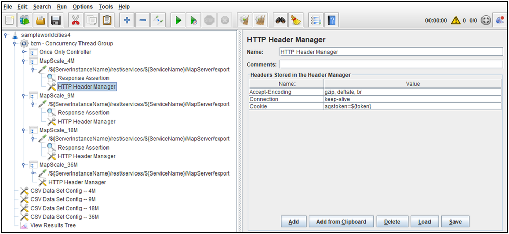

Token Support in the Map Request Headers
With the token variable populated from the Authentication logic, the HTTP headers for each secured map request can be expanded to include it under the name Cookie with the value: agstoken=${token}
Note: The HTTP Cookie Manager is not used in this Test Plan example
From a technical point of view, the token could have been passed in the request as a key/value pair, but for improved security, it is passed as an HTTP header.

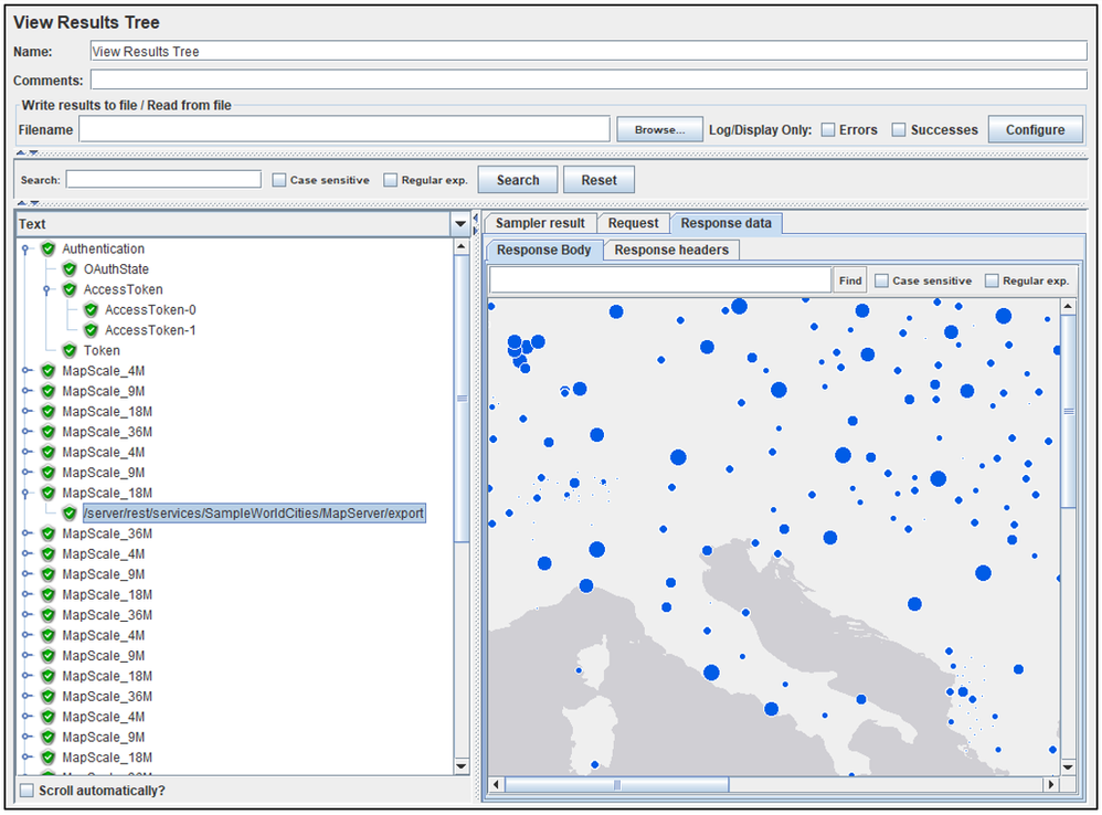

Validating the Test Plan
  • Ensure the View Results Tree is enabled and Start the test (e.g. the green arrow) to validate the responses.
    • The green check marks for all parts of the Authentication indicate that a valid token was obtained from the provided credentials
    • The image from the export map calls indicate that a request was successfully issued for the secured service
