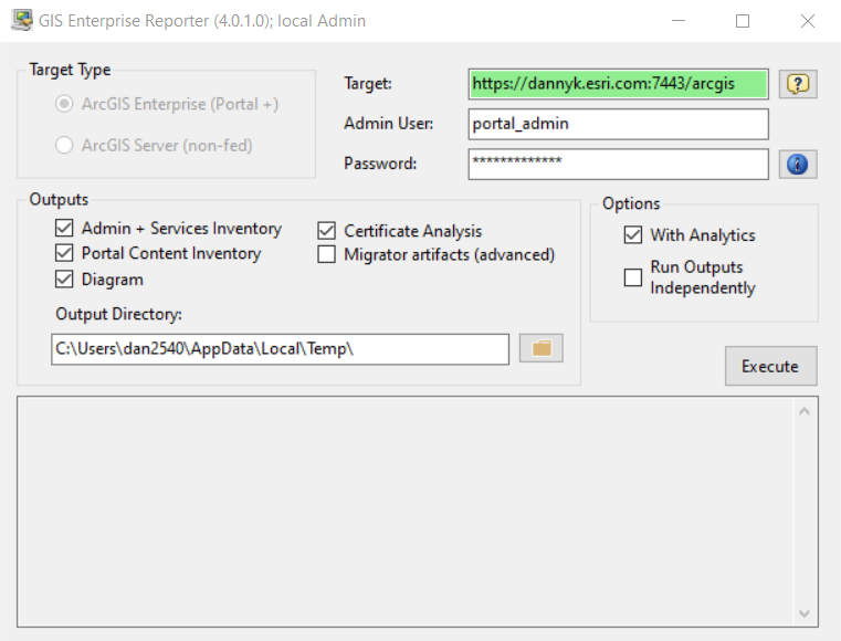

The GIS Enterprise Reporter user interface is intended to have few options in the hopes that it is relatively straight-forward to execute.
In principle, you give it a Portal for ArcGIS "Target", with an administrative credential for that Portal, tick some checkboxes, click "Execute", and wait for it to complete.

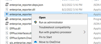

It is not necessary to run Reporter as a local machine administrator.  However, doing so will usually allow it to gather more information for you.  And, it may help you to overcome some potential execution challenges.
If you wish to run the application as a local machine administrator (assuming you are a member of that local machine Administrators group), right click on the enterprise_reporter.exe executable and select "Run as administrator" from the context menu.

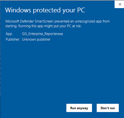

You may or may not receive a message from your operating system or security software that discourages you from running this application.

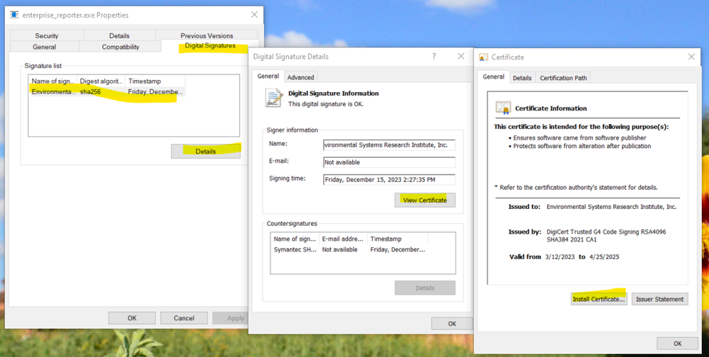

This application is digitally signed by Esri with a chain of authority from a public Certificate Authority.  So, it is unlikely that the message will mention certificate trust.  But, if it does, you may wish to explore importing the trust chain into your trusted repository.  To initiate the "installation" workflow for the certificate, follow the steps show in the screen capture below :
Selecting "Current User" and "Automatically select the certificate store based on the type of certificate" are the appropriate options on the "Install Certificate" wizard panels.  This may relieve you of the warning.
Or, if you are a machine administrator, you may have options to execute the application.  To do so, you may have to click buttons that say things like "More Options", "Run Anyway", etc. ... depending on what is issuing the warning and your rights.  For example:
These technical methods are not offered to circumvent the guidance of your organization with respect to third party executables.  Please use the privileges granted to you by your organization responsibly.

What Is the Right Value for "Target"?
There are three basic options:
  1. The FQDN ('portalmachine.domain.com') of the machine
  2. The 7443 endpoint for Portal ('https://portalmachine.domain.com:7443/')
  3. The WebContextUrl for Portal ('https://proxy.domain.com/portalcontext')
The first two options amount to the same thing.  If you enter the FQDN of your Portal machine (either machine in the case of a two-machine "high-availability" Portal), Reporter will fix-it up into option #2 for you.  In addition to being relatively straight-forwards, this is usually the best option for "Target" value as well.  So, it is recommended that you use the FQDN (fully-qualified domain name) of a Portal machine (the machine's "A RECORD").
Of course, this implies that your network will allow you to get to Portal's 7443 port from where you are running Reporter.  This is why the first tip encourages you to run Reporter on your server network because it is on that network that this network pathway will be allowed.
The third option is to provide the WebContextUrl (or Web Adaptor-style address) as the target.  This generally works.  However, Reporter only knows about "Portal tier authentication".  So, if this pathway (WebContextUrl) involves "web tier authentication" or requires SAML, OIDC, etc., Reporter will not be able to authenticate.
As you might be able to infer, the values for "Admin user" and "password" must be a user that has administrative rights on your Portal and is authenticated at the Portal tier.  This certainly includes Portal's "Initial Administrator Account".  But, you can also use any other account that is a Portal administrator and can get a token directly from Portal's 7443 REST endpoints.

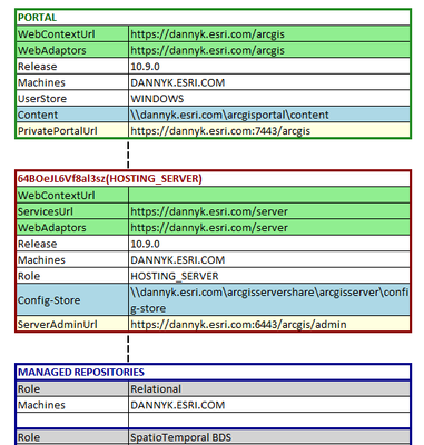

"Diagram": The diagram provides a high-level picture of the logical structure of your Enterprise.  This is an example from a very simple (development environment) system:

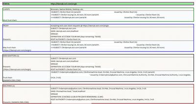

"Certificate Analysis": Reporter does its best to connect to each of the HTTPS endpoints in your Enterprise (i.e. Reverse proxies, Web Adaptors, Portal's on 7443, Server's on 6443, etc.), discovering the certificates and reporting on various facts like certificate subjects, expirations, and trust chains.  There are several sheets in the Excel, each sheet corresponding to a different HTTPS access pathway.  For example:
