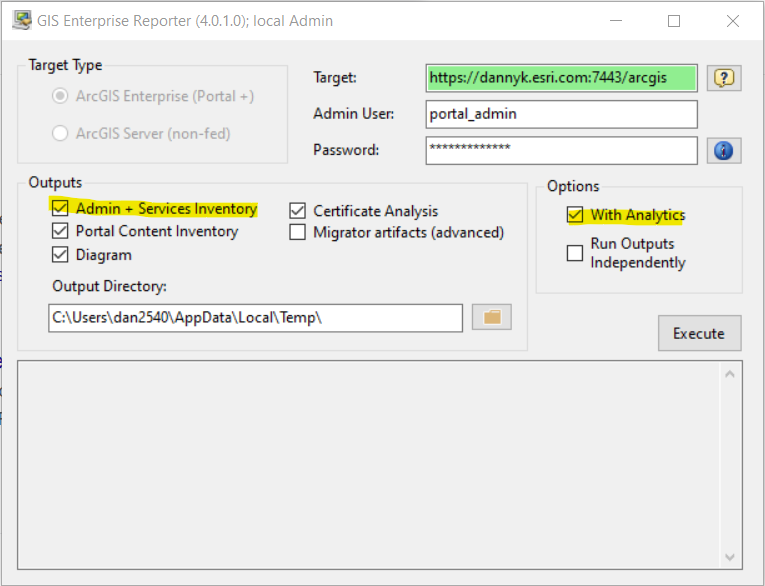

The default execution parameters of GIS Enterprise Reporter will generate the "Admin" Excel output.  The "Admin + Services Inventory" checkbox creates and populates the workbook from the Admin API.  The "With Analytics" checkbox will calculate a variety of aggregate statistics and other information of interest from the raw outputs, placing them in additional sheets in the same Excel workbook.

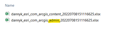

The workbook will be placed in the output directory and will bear a name indicating the name of the ArcGIS Enterprise followed by "_admin_" and a timestamp as shown here:

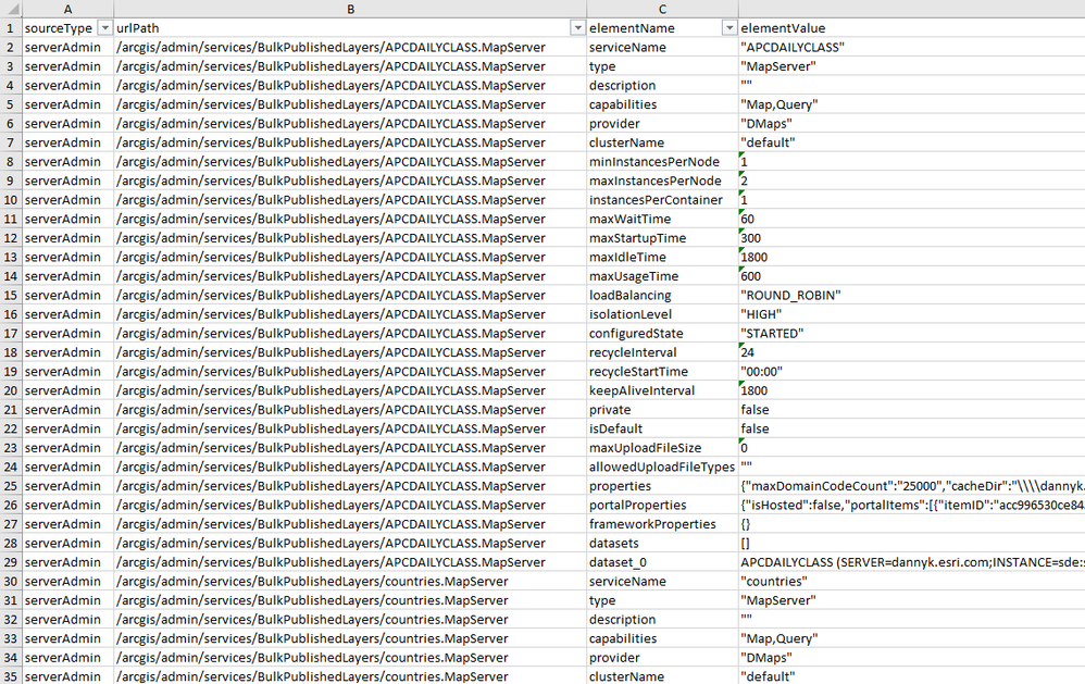

  • serversvc: An exhaustive list of all of the properties of all of the services in the ArcGIS Server Site.  If you need to know any particular fact about a service that ArcGIS Server knows, it can be found here.

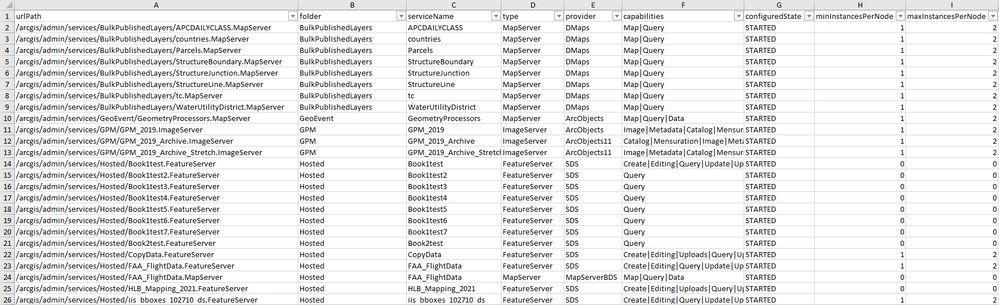

  • serversvn: A "normalized" listing of the most commonly used properties of the services in the ArcGIS Server Site.  The sheet is more useful to understand the services inventory over-all.
The "Normalized" Services Listing
The "normalized" services listing is a good place to start.  Each line is a service and some essential pieces of information about it.

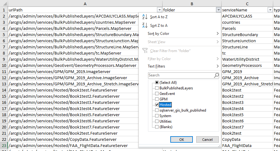

The first row has filters that can be used to focus on information of particular interest.
The Detail in "serversvc"
The "serversvc" sheet has one line per service property.  This makes it less convenient for understanding the big picture.  But, if you want to know the recycleStartTime, the portalProperties, or the referenced datasets, they are available here.

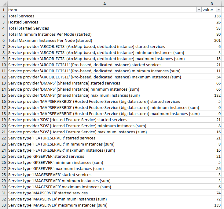

svc_analytics
"svc_analytics" contains a variety of calculated statistics about the services (and the service instances) in the Site.
The first few statistics are about the services over-all.  However, most of the statistics are focused on only those services that are running.
The "Total Minimum Instances Per Node (started)" is of interest because this is the number of instances that exist as soon as ArcGIS Server starts.  The "maximum" statistic is the upper limit.  However, it is almost never the case that all services have their maximum instantiation at the same time.
Statistics are presented by "provider" (indicating something about how the service was published and how it runs) and "type" (indicating something about what it can do).  As noted, these statistics focus on the services that are running, and their min/max instancing.
