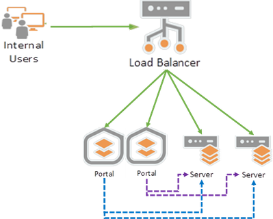

To secure external access to ArcGIS Enterprise, it is common to host a load balancer in a DMZ, and implement a Split Domain Name System (Split DNS), i.e. internal access to ArcGIS Enterprise DNS (e.g. gis.company.com) will be resolved to an internal load balancer IP, so internal users will stay behind the firewall, and external access to ArcGIS Enterprise DNS will be resolved to an external (DMZ) load balancer IP.
Load balancing configuration with external access

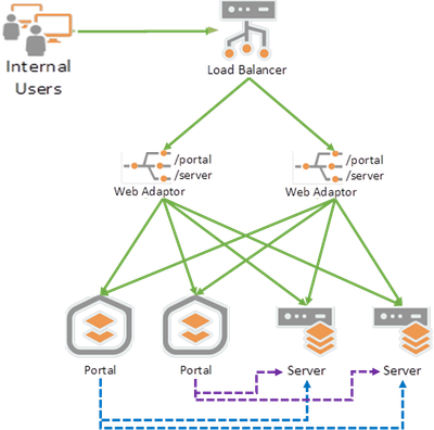

When you use ArcGIS Web Adaptors, the web adaptors will take care of performing the health checks against the portal and the servers. In this case you can configure the load balancer with basic TCP/443 health check or a static page health check, with standard health check settings for timeout, failure trigger, polling interval, and healthy threshold.
If you configure the load balancer to access portal and/or the servers directly, e.g. if you don’t include web adaptors in your architecture, or if you use dedicated load balancer URL for private portal URL (port 7443) or federated server administrative URL (port 6443), you should configure the load balancer to check the health of the portal and server machines.

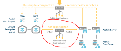

Thanks, David. I think I wasn't clear 🙂 Ports 7443 & 6443 will NOT be exposed to public. As you said, they must go through public URL, gis.company.com.
I was referring to the internal Admin load balancer setup for admin communication / private URLs. I think it matches with the second option you explained i.e., to have admingis.company.com for private communication. For this internal admin balancer, my understanding is that it has to accept traffic on 6443 & 7443 and then redirect, based on port #, to portal & server machines accordingly. These URLs will also be used for federation. I'm wondering if I'm missing any other option - rather than allowing traffic on 7443/6443 for this internal load balancer. Thanks again for your time.
e.g., admingis.company.com:7443/arcgis/portaladmin
admingis.company.com:6443/arcgis/manager
This setup is similar to the below recommendation from ESRI - without the web adapters.
DavidHoy
Sorry, I did miss that you were talking only about the internal Load Balancer.
Well - you could - as you say (and as the Esri diagram shows) use :7443/:6443 as incoming for the internal LB, but, as your IT group are not keen on that - you could instead use the strategy I suggested - as you have F5 that is capable of url rewrite,
direct requests coming in on gisadmin.organisation.com/portal to the portal servers on :7443 and  for gisadmin.organisation.com/server to the server site machines on :6443
you will need to set up the Health Checks for these as Noah's article suggests

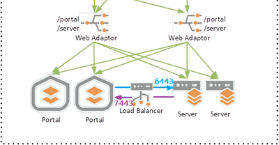

@NoahMayer  and team, I have a question about the impact of not using the web adaptor in a linux deployment for ArcGIS Enterprise.
We are considering forgoing the use of the web adaptor. It looks like, after we configure with tomcat, we still need to configure with a load balancer when we are implementing our high availability configuration.  In that light, given that the web adaptor is an optional component, can we discard it and use the architecture in figure 3?  I have included Figure 1 that I obtained from this blog (https://community.esri.com/t5/implementing-arcgis-blog/planning-load-balancer-configuration-for-high...).  Figure 2 is the approach we are considering for the case if we decide to use the web adaptor.
Note that our site is internally facing so we do not require external access. The dotted lines in figures 2 and 3 refer to the federation of server with portal.
I would also appreciate if there is anyone on this forum who has a Linux deploy to share any insight s they may have.  The insights may include any issues with migrating data from a windows deployment to a new Linux deployment.
Thank you for your help.
Figure 1 (from Esri)
Figure 2 (using web adaptor)
Figure 3  (Preferred without the web adaptor)

@NewlandAgbenowosi1 you can deploy highly available ArcGIS Enterprise without web adaptors. Please refer to this documentation: Integrate your portal with a reverse proxy or load balancer
Things to notice are load balancer type (layer 3/4 or layer 7), ports configuration (e.g. 443>7443 and 443>6443, and potentially 7443>7443 & 6443>6443) supported subdomains and sites context names, X-Forwarded-Host header and redirects, and health check configuration.
Another point to consider is how to configure your privatePortalURL and Server Administrative URLs. You want those URLs to point to a load balancer URL and not to a machine URL for high availability. These can be either the same URL as the WebContextURL / Services URLs, or a separate load balancer services via the internal ports, e.g. 7443 & 6443.

Ranga_Tolapi
Is it the right way to depict internal load balancer between Portal for ArcGIS and ArcGIS Server for administrative communication?
DavidHoy
Yes - this is one of the possible ways to setup the administrative paths.
But if setting up an internal Load Balancer is onerous, it is possible to just use the public load balancer addresses via :443 i.e .PrivatePortalURL same as webContextURL and Server Admin URL same as the Server Services URL
But, this does mean:
- Admin Access must be enabled in the Server Web Adaptor
- The Public Load Balancer must be accessible from the Portal and Server VMs
- (this isn't always the case when the Public ALB is in a DMZ)
NoahMayer
@Ranga_Tolapi - the internal load balancer, which will usually be used for the portal's privatePortalURL and the federated servers' Administrative URL, is used for intermachine communication between the federated servers and the portal machines, but also for administrative operations, including publishing referenced services, so it's not only between Portal for ArcGIS and ArcGIS Server but also between admin/publisher users and ArcGIS Enterprise.
As David mentioned, it is very common for our customers to use the external load balancer URL also for these URLs, and then you don't need internal load balancer. This is a more simple configuration. Some customers prefer to separate between an external load balancer and an internal load balancer for security and/or network considerations.
