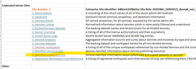

Hello! Thank you so much for providing this very powerful tool, we have used it quite a lot. I have a (hopefully) simple question: our organization is attempting to track down what EGDB connections were used when the map services on our stand-alone ArcGIS Server sites were published. I know I can find this information in the D:\arcgisserver\directories\arcgissystem\arcgisinput\[Folder]\[xyz.MapServer]\extracted\manifest.xml file, however, I am curious if Enterprise Reporter is capable of collecting all of this information into a single source? I have briefly examined its outputs and I definitely see registered data stores, but I have been unable to identify specific service database connections.
Any advice is very appreciated 🙂  Thank you, kindly.
DannyKrouk
@cboyerTucson  Thanks for the kind words.
You might be looking for:
Which gives you this kind of thing:
If that's not quite what you're after, perhaps you can tell me what is missing relative to your interests?
Thanks 🙂
cboyerTucson
Dearest @DannyKrouk , you have just saved me HOURS and HOURS of work. If I could bake you a box of cookies, you'd best believe I would. Thank you so so much for your lightning quick and immeasurably helpful reply and work on this incredible product. 🙏

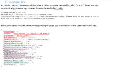

@DannyKrouk  This tool is amazing and has saved me a ton of time tracking dependencies on services/databases when we migrated our org to a new server stack last year that had a totally revamped architecture.
I would like to use the output from this this as the source data for some Power BI dashboarding that we are looking to develop to give an admin perspective of our Prod/Test/AGOL environments.  The part I'm trying to work though is figuring out how to set this up as a scheduled task.  I have been looking at Python subprocess and I can open the program but am struggling with the arguments.  Do you have any advice for scheduling Enterprise Reported to run on an interval.
DannyKrouk
@Daniel_C  Thank you for the kind words!
There is a separate executable called "er.exe" which can be used for scheduled execution of GIS Enterprise Reporter.  That's kind of an historical accident.  The code called by the executable is the same as that which gets called by the GUI.
Section #6 in the Word document that comes with the tool discusses how to use the command-line interface.  Essentially, you put your parameters in a json file and provide the file as an argument to the command-line.  Here's a partial screen capture from that section of the doc:
Please note that AsynchronousExecution is no longer supported (i.e. the parameter should either be absent or the value should be "false" if it is present) ... another historical accident (sorry).
Does this help?
Daniel_C
New Explorer
@DannyKrouk
That is exactly what I needed.  Appreciate the info!
