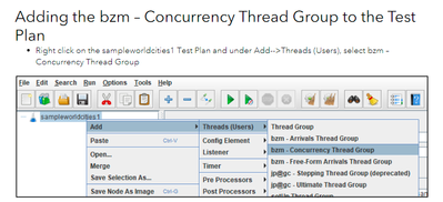

Adding the bzm – Concurrency Thread Group to the Test Plan
  • Right click on the sampleworldcities1 Test Plan and under Add-->Threads (Users), select bzm – Concurrency Thread Group
  • Under the sampleworldcities1 Test Plan, click on bzm – Concurrency Thread Group
  • Configure the step load logic with the following:
    • Target Concurrency: 10
    • Ramp Up Time (min): 20
    • Ramp-Up Steps Counter: 10
With the bzm – Concurrency Thread Group plugin, the configured step load logic can be easily seen and visually confirmed in the chart graphic above. This test will be set to run for 20 minutes, will increase pressure by using 10 different steps (adding 1 concurrent test thread at a time every 2 minutes), hit a maximum of 10 concurrent test threads then will stop.

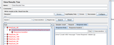

Validating the Test Plan
  • Use the View Results Tree listener to assist with validating the response in the GUI from the remote server
    • Right click on the Test Plan (sampleworldcities1) and under Add-->Listener, select View Results Tree
  • Select View Results Tree, then Click on the green triangle at the top of the Apache JMeter GUI
  • Following the configured step load, JMeter will start by repeatedly sending requests, (initially) one at time.
    • The green shield with a checkmark is a sign of a successful request, if this is seen, wait several seconds for a handful of requests to be sent and responses to be returned.
    • Clicking on one of the MapScale_9M green shields will show the Sampler result tab which displays information such as:
      • Load time (response time)
      • Size in bytes (Header and Body)
      • Error Count
      • Response code
      • ContentType
Note: This info is great for validating the test playback but also useful for performance troubleshooting
  • Since this test is exercising the export map function, a visualization of the requested image would also assist with the Test Plan validation.

Hello @AaronLopez , thanks for these great articles as it is exactly what I need to do right now but I can't see to get it to work.
I have been working through the steps but seems like I might need to generate a token for it to work from my end. The image below is from JMeter, so would appreciate any help. I am running it as myself but does it need to be run as the ArcGIS server administrator?
AaronLopez
Hi @DeanHowell1,
Thanks for reading our Article on Creating a Load Test in Apache JMeter.
I agree with you...it appears your deployment is requiring a token in order to consume the SampleWorldCities map service.
We recently added a walkthrough on Using Apache JMeter to Load Test an ArcGIS Enterprise Authenticated Service (Intermediate/Advanced) which may help. At the end of that Article, there is a Test Plan you can download which includes all of the pieces listed in the discussion.
Hope this helps!
Aaron

AYUSHYADAV
Hi @AaronLopez,
In your above workflow, you have mentioned adding bzm – Concurrency Thread Group to the Test Plan.
But that option/tool is not visible in Jmeter. Just wanted to ask whether we need to install any plugin for that or how we will get that in our test plan.
Thanks
Ayush
AaronLopez
Hello @AYUSHYADAV
The "bzm – Concurrency Thread Group" does require the JMeter Plugins Manager to be installed. With this in place, JMeter will automatically download and install any additional items that are referenced in the Test Plan when you open it. This is really convenient but you'll need the Plugins Manager to be installed.
To install the Plugins Manager:
Download the plugins-manager.jar file, and put it into JMeter’s lib/ext directory (e.g. C:\apache-jmeter-5.4.3\lib\ext). Then (re)start JMeter.
