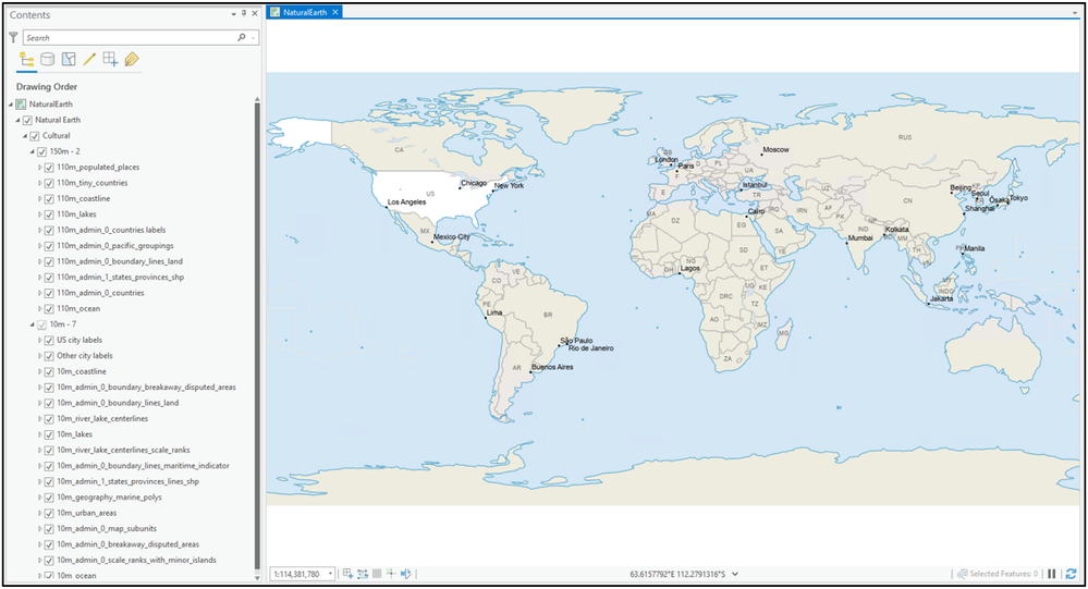

The Natural Earth Dataset
Although the steps should work with any data, the walkthrough of the process in this Article might be more effective if they can be directly followed. In such cases, it is great turning to the Natural Earth datasets which provides some decent map detail (at smaller scales) covering the whole world.
  • Download the Natural Each dataset here
    • The download above is a subset of the larger Natural_Earth_quick_start.zip and includes a modified MXD for ArcMap 10.8.1 and ArcGIS Pro 2.8 project
      • Either can be used to publish and create a cached map service to ArcGIS Enterprise
  • The Natural Earth subset of data should look similar to the following when opened in ArcGIS Pro (or ArcMap)
  • This Article will not cover the details of creating, configuring or publishing a cached map service in ArcGIS Enterprise. For information on such actions, see:

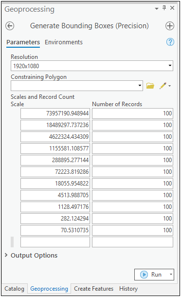

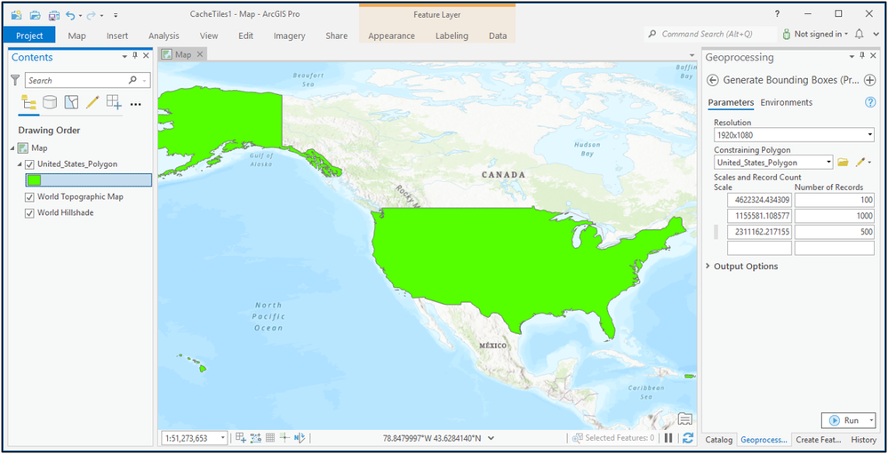

The Generate Bounding Boxes (Precision) Tool
  • Launching the Generate Bounding Boxes (Precision) tool should present an interface similar to the following:
  • Before running the tool, let's adjust the input to target the data generation process to:
    • Specific map scales (in this case three different scales)
      • Scales 4622324.434309 and 1155581.108577 were kept
      • Scale 2311162.217155 was added
      • The number of records to be generated was adjusted the reflect larger map scales
        • As the scale number goes down, we want to tool to generate more boxes
    • A specific area of interest (optional)
      • A polygon of the United States was added to a new map
      • This feature was set as the Constraining Polygon
  • Click Run
    • Tool execution may take a few moments

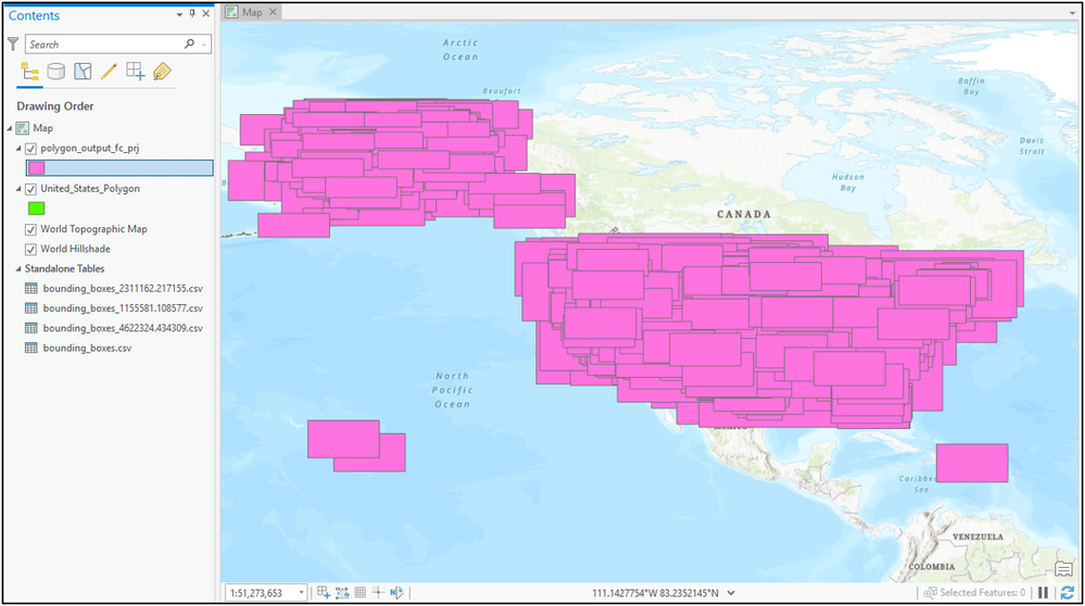

Visualizing the Generated Data in ArcGIS Pro
  • The Contents screen will populate by adding a new feature classes that is visually representing the generated data
    • Not all the generated map scales will be immediately seen

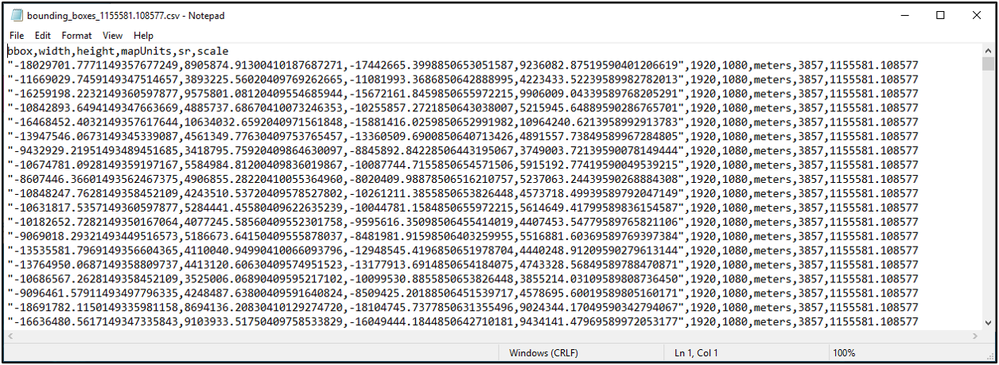

Visualizing the Generated Data in a Text Editor
  • Using the file system explorer, navigate to the ArcGIS Pro project used for generating the data and open one of the csv files using your favorite text editor
    • The file contents should look similar to the following:
  • The Apache JMeter test will be configured to convert each of these bound boxes into the corresponding cache map tiles

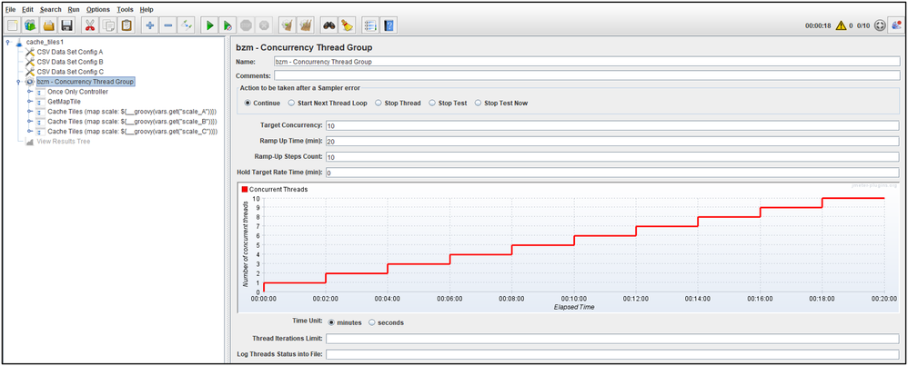

The Cached Map Service Test Plan
  • To download the Apache JMeter Test Plan used in this Article see: cache_tiles1.zip

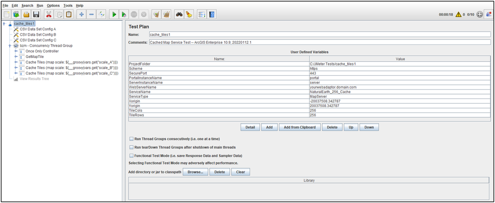

  • Opening the Test Plan in Apache JMeter should look similar to the following:

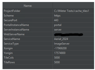

    • Adjust the User Defined Variables to fit your environment
      • Xorigin, Yorigin, TileCols, TileRows are properties of the created map cache that can be found on the REST endpoint page of the service
        • TileCols and TileRows are typically found under Tile Info Height and Width

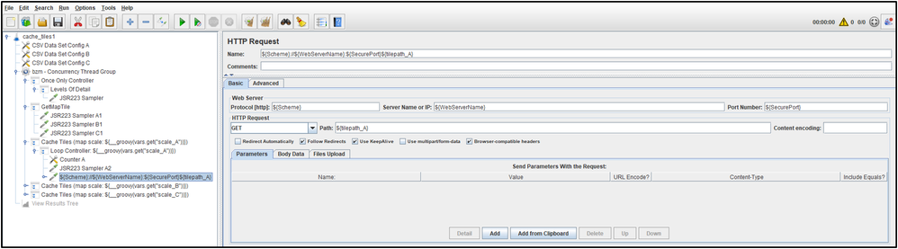

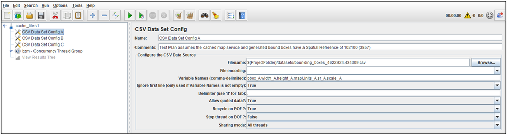

CSV Data Set Config
The CSV Data Set Config elements in JMeter are used to reference the newly generated test data from the file system. The current version of the Test Plan is built to utilize 3 different CSV files (one for each map scale data file).
Note: Other that the User Defined Variables and the setting of the Filename in the CSV Data Set Config elements, there should not be anything else that requires editing or changing in the Test Plan. The test logic is listed below just to explain how the values in the HTTP Request become populated.

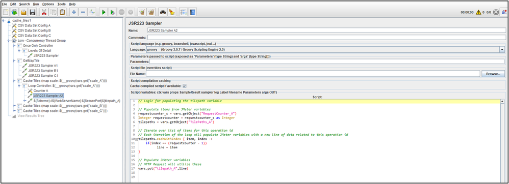

Levels Of Detail List Logic
To avoid more complex JMeter test logic, 24 fixed map cache levels of detail are placed inside a class in a JSR223 Sampler test element. That "complex alternative" would be to connect the endpoint of the service at the start of the test and pull down the cache tile metadata. Putting HTTP logic into JSR223 Samplers is technically doable, but not the route I chose.
  • There is only one JSR223 Sampler inside the Levels Of Detail Transaction
  • This item is executed only once, at the start of each test thread
    • The element contains 24 fixed cache levels of detail, with level 0 starting at scale 591657527.591555
      • If your cache scheme starts at a different scale for 0, then the JSR223 Sampler will need to be manually adjusted
  • This JSR223 Sampler does not need to be edited to run the test
    • This assumes cached map service has a Spatial Reference of 102100 (3857)

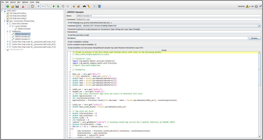

GetMapTile Logic
The JSR223 Samplers inside the GetMapTile Transaction is the logic responsible for taking a bounding box and transforming it into the corresponding cache tiles.
  • There is one JSR223 Sampler for each map scale (e.g. one for each corresponding CSV Data Set Config)
    • CSV Data Set Config A --> JSR223 Sampler A1
  • This is executed with every test thread iteration
    • This is executed frequently...every time a new bounding box is read in
  • These JSR223 Samplers do not need to be edited to run the test
Note: JSR223 Samplers using Groovy are generally executed quickly and add very little overhead to the test
 GetMapTile -- JSR223 Sampler A1 (Full Logic):

     if (mapresolution >= lod_resolution)
     	break
tileCols_var = vars.get("TileCols")
cols = Double.parseDouble(tileCols_var)
tileRows_var = vars.get("TileRows")
rows = Double.parseDouble(tileRows_var)
// Origin of the cache (upper left corner)
xorigin_var = vars.get("Xorigin")
xorigin = Double.parseDouble(xorigin_var)
yorigin_var = vars.get("Yorigin")
yorigin = Double.parseDouble(yorigin_var)
// Get minimum tile column
double minxtile = (xmin - xorigin) / (cols * tileresolution)
// Get minimum tile row
// From the origin, maxy is minimum y
double minytile = (yorigin - ymax) / (rows * tileresolution)
// Get maximum tile column
double maxxtile = (xmax - xorigin) / (cols * tileresolution)
// Get maximum tile row
// From the origin, miny is maximum y
double maxytile = (yorigin - ymin) / (rows * tileresolution)
// Return integer value for min and max, row and column
int mintilecolumn = (int)Math.floor(minxtile)
int mintilerow = (int)Math.floor(minytile)
int maxtilecolumn = (int)Math.floor(maxxtile)
int maxtilerow = (int)Math.floor(maxytile)
Scheme_var = vars.get("Scheme")
WebServerName_var = vars.get("WebServerName")
ServerInstanceName_var = vars.get("ServerInstanceName")
ServiceName_var = vars.get("ServiceName")
ServiceType_var = vars.get("ServiceType")
def cacheRequest
def tilePaths = []
int count = 0
for (int row = mintilerow; row <= maxtilerow; row++)
	// for each column in the row, in the map extent
     for (int col = mintilecolumn; col <= maxtilecolumn; col++)
          cacheRequest = ("/").concat(ServerInstanceName_var).concat("/rest/services/").concat(ServiceName_var).concat("/").concat(ServiceType_var)
          cacheRequest = cacheRequest.concat("/tile").concat("/").concat(tilelevel.toString()).concat("/").concat(row.toString()).concat("/").concat(col.toString())
          count++
          tilePaths.add(cacheRequest)
def requestCount = count.toString()
vars.putObject("RequestCount_A",requestCount)
vars.putObject("TilePaths_A",tilePaths)
Cache Tile Loop and Path Population
There are several components needs for this part of the Test Plan. With the bounding box translated into the corresponding cache tiles and assembled into a list of URLs, a third JSR223 is needed to place each URL into a variable inside a loop. The loop logic takes place inside the Cache Tiles transaction.
    • CSV Data Set Config A --> JSR223 Sampler A2
  • There is a Loop Controller added to only ask for the actual number of tiles per bounding box since this amount can change extent to extent
    • The number of tiles that correspond to each bound box vary by extent but also but the map resolution (1920x1080)
      • Higher screen resolutions require more tiles
    • The Loop Controller contains the following elements:
      • Counter
      • JSR223 Sampler
      • HTTP Request
Loop Controller
Counter
JSR223 Sampler
HTTP Request
All of the test logic above exists just for this component of the test. For each map scale, there is only one HTTP Request! This simple design favors readability and maintainability.
Note: The HTTP Requests contains a Response Assertion element to validate the items returned from the server. If the content type of the response is image/jpeg or image/png, then the request will pass. However, some VectorTileServer caches may return a Protocolbuffer Binary Format (*.pbf) file. In these cases, the Patterns to Test would need to be manually expanded to the following: image/jpeg || image/png || application/octet-stream || application/x-protobuf
The Thread Group Configuration
The JMeter Test Plan is currently configured for a relatively short test of 20 minutes. Cached map services perform well, so a lot of throughput will be taking place within each step (2 minutes per step) and from the test overall.
  • Different environments may require an alternative pressure configuration to achieve the desired test results, adjust as needed

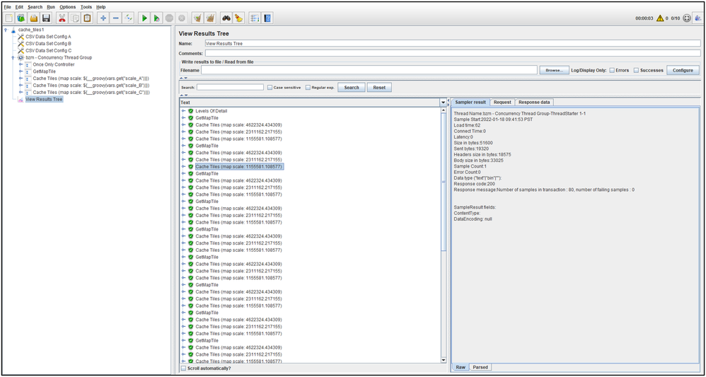

Validating the Test Plan
As a best practice, it is always a good idea to validate the results coming back before executing the actual load test.
  • Use the View Results Tree listener to assist with the validation
    • The Test Plan includes a View Results Tree Listener but it is disabled by default
      • Enable it to view the results
  • From the GUI, Start the test
Transactions
  • Select one of the "Cache Tiles" Transactions
    • The results should resemble the following:
  • In this example, all the transactions completed successfully (e.g. the green checkmark)
    • Cache Tiles (map scale: 4622324.434309)
    • Cache Tiles (map scale: 2311162.217155)
    • Cache Tiles (map scale: 1155581.108577)
  • Selecting one of the transactions and the Sampler result element lists some key information
    • Take a quick glance at the Size in bytes
      • In the example above, the Transaction size was over 50KB which suggests decent tile data (for this dataset) was being returned and the responses were not all "blank" images
    • The Number of samples in the transaction was 80
      • Since there is a JSR223 Sampler with every tile request, this actually resulted in 40 tiles being downloaded
    • The Load time shows 62 (ms), meaning it only took 0.062 seconds to pull down 40 tile images
Requests
  • Expand the selected Transaction
    • In this example, Cache Tiles (map scale: 1155581.108577)
  • Select one of the HTTPS requests
  • In this example, the select request completed successfully (e.g. the green checkmark)
  • Take a quick glance at Load time
    • In this example, the individual tile request only took 2 ms (0.002 seconds) to download
  • Clicking on the Response data tab allows you to preview the requested tile:
Note: Once visual validation and debugging is complete, it is recommended to disable the View Results Tree element before executing the load test

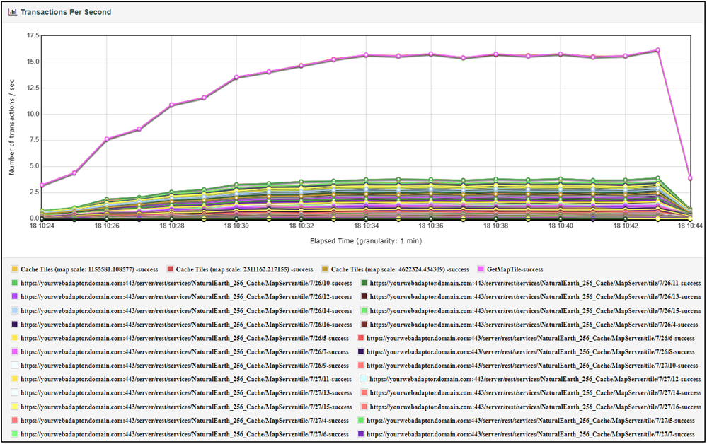

  • The auto-generated JMeter Report can provide insight into the throughput of the cached map service under load
    • This report is auto-generated from the command-line options passed in from the runMe.bat script
Throughput Curve
  • The JMeter Report for a cached map service load test may appear sluggish and slow when viewed in a web browser
    • This is due to the default nature of its composition, which attempts to render every unique request in some of the charts
      • In a test such as this, there will be many
      • From the chart legend, select all JSR223 Sampler items to disable their rendering (as they may skew the scale)
  • In this case, the peak throughput for any one of the given map scale transactions of cached tiles was about 15 transactions/second
    • Since 3 map scales were tested, the total transactions per second achieved was 45 transactions/second
      • This equated to around 162,000 cache transactions/hour
    • The peak throughput appear to occur at the 10:34 mark

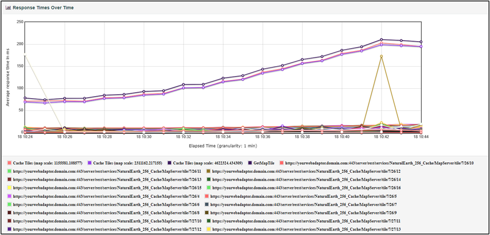

Performance Curve
  • The performance of the cache throughput was good at roughly 120 ms or 0.12 seconds
    • This was observation was taken where the peak transactions/sec occurred at the 10:34 mark

I have also uploaded an update to the cache tile test: cache_tiles2.zip
This version contains some added logic to better support vector tiles caches.
I added a User Defined Variable called "TileExtension". If your vector tiles show the extension for a "Protocolbuffer Binary Format" file, simply set TileExtension to .pbf (note the dot, as it would need to be included). Otherwise, leave this variable empty.
I also added additional ContentTypes to the Response Assertion rules in order to check for a returns that would be in "Protocolbuffer Binary Format".
Another important detail, the default User Defined Variable value for the ServiceName is NaturalEarth_256_Cache. However, if your cache was a Hosted service, this would be set to Hosted/NaturalEarth_256_Cache. The ServiceName should include the preceding directory, if it exists.
Lastly, if testing a vector tile cache, the User Defined Variable for ServiceType would need to be changed to VectorTileServer.

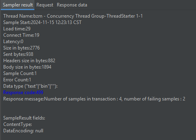

SGTomlins
@AaronLopez - I am running this test,  however i am getting the following errors.  It looks like it can find the tile..
but I am not sure what this is exactly telling me....
Can you assist my investigation?
Thank you
AaronLopez
Hi @SGTomlins,
I believe the Response code: 499 is a token related error
Most likely the service your test is consuming requires authentication. As it is currently, cache_tiles2.zip does not have authentication functionality added in.
A potential solution would be to look at the authentication components from this test:
Using Apache JMeter to Load Test an ArcGIS Enterprise Authenticated Service (Intermediate/Advanced)
and copy them into the tile test.
Hope that helps
Aaron
