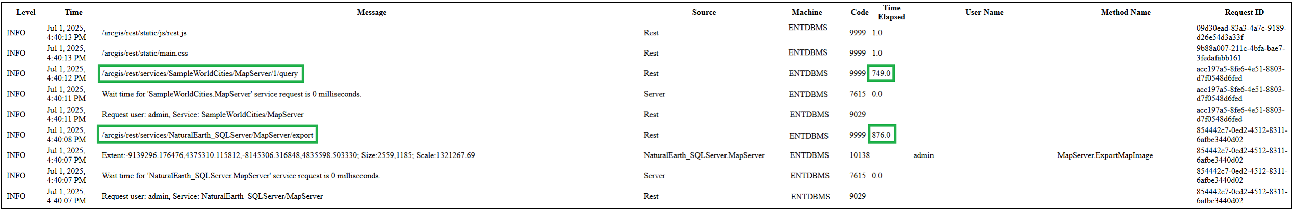

For example:
From this screenshot, the Info entry (with Log Code 9999), contains a listing of the request's URL (under the Message column) and the response time (under the Time Elapsed column).
With the Url, you get name of the service of requested as well as the function called.
Note: The time of the Info request entry is in milliseconds. ArcGIS Server may list other log entries at the level of Info that do not correspond to a request's response time.
While you can expect to find times for requests for resources like map services and feature services, you'll see also observe entries that go through the framework but do not utilize an ArcSOC service instance in the traditional sense. For example, calls for static files such as rest.js and main.css (as shown in the screenshot).
In addition to those static items, you may also see response time entries for such resources as hosted feature services and vector tile services. These items, if such services exist in your deployment, are a nice bonus! Granted, requests for such items are typically very fast, but by examining Info type entries, analysis can be performed that usually require an access log.

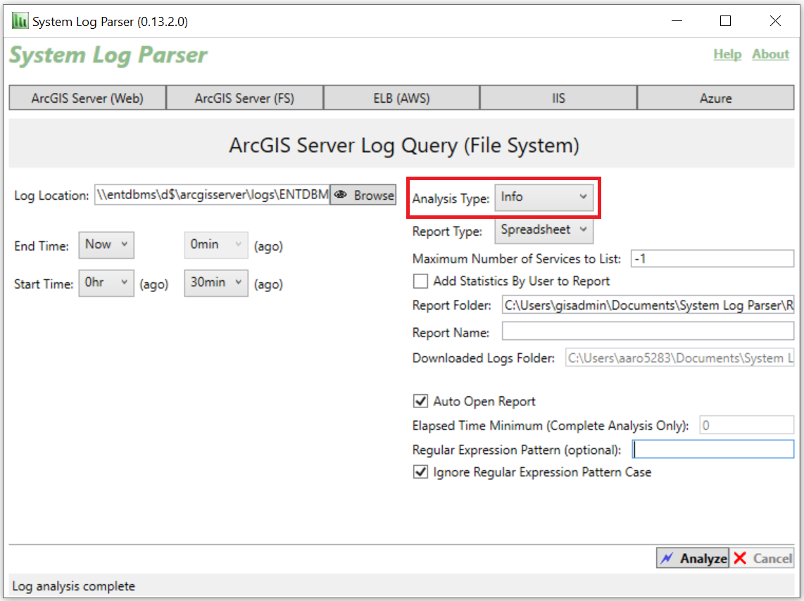

Create a System Log Parser Report from Info Log Level Entries
The ability to create a System Log Parser report from the Info Log Level entries can be found from the Analysis Type option, under ArcGIS Server Log Query (File System).
Note: ArcGIS Server's Log Level must be set to at least Info to create a System Log Parser report based on Info entries.

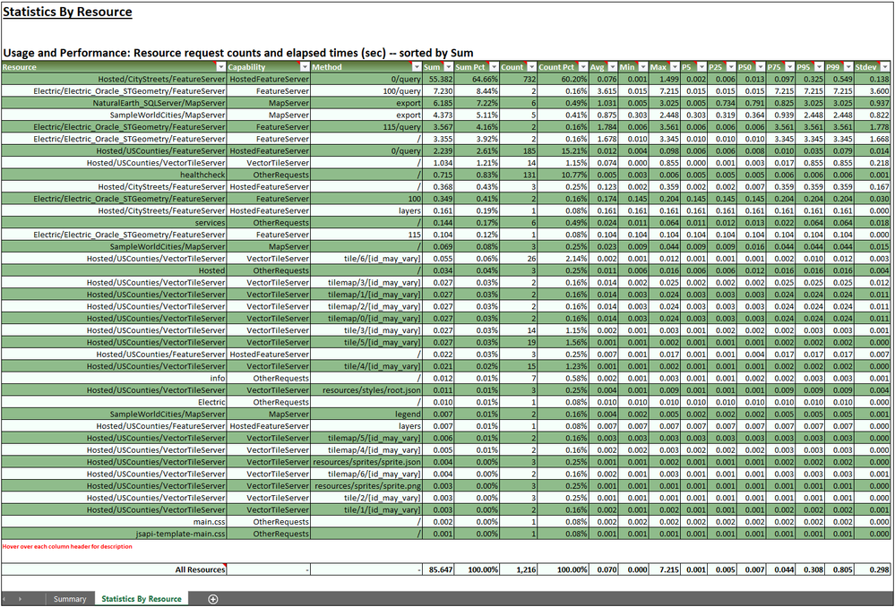

System Log Parser Info Report
The System Log Parser Info report will show response time statistics for services requests as well as other items that go through the ArcGIS Server framework.
