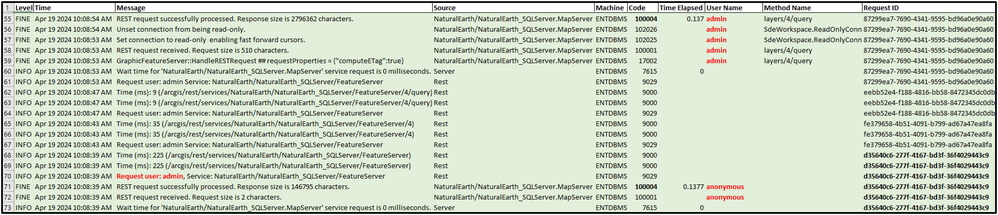

When System Log Parser queries the ArcGIS Enterprise (e.g., ArcGIS Server) logs, it reads the "User Name" field to determine the member identity for each log entry of a successful request.
This value is only read from very specific log entries (e.g., where the log Code=100004). Such entries also have the final elapsed time duration of the work performed (e.g., how long the request took from the ArcGIS Server's ArcSOC.exe point of view). These resources are some of best places to look for quantification analysis of the Site.
For many service request log entries, this lists the authenticated Portal member username value...as expected.
But, there are log entry cases when a member has just authenticated to the Site and the recorded value of "anonymous" is listed instead, but anonymous (e.g., a non-authenticated user) was not actually reading the service.
If log queries are executed manually (for the same window of time) through Manager or the REST Admin API, additional details are revealed which can help explain this initial user impersonation by the entity  called "anonymous".
By using the Request ID field in the logs, one can correlate multiple entries together (since all of the same Request IDs belong to the same request...which is really awesome).
So, while the Code=100004 entry shows the user as "anonymous", the Code=9029 entry actually lists the requesting user's Portal member identity. In this case, "admin".
Subsequent queries by that user are listed as the expected name (e.g., and not "anonymous").
Note: In the log entry screenshot above, "NaturalEarth/NaturalEarth_SQLServer.MapServer" was a service shared only to specific Portal members.
Note: System Log Parser does not currently present this additional user impersonation detail. Whatever value is recorded under User Name is what SLP uses for the Statistics By User worksheet.
Note: There can also be a separate Code=8522 log entry which lists the recorded member value under the User Name column.

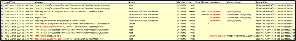

Actual Anonymous Requests to Services Shared to the Public
There are also log entries where the value for the "User Name" field can list "anonymous" as the member, but this where it is truly representing anonymous.
In this situation, the logs are identifying a successful request made by someone for a publicly available service where the connecting client was not challenged to authenticate. In other words, the service was intentionally shared to Everyone (e.g., the public).
By performing another manual, in-depth log query (for the same window of time) for these types of requests, more details can be derived which show that associated Code=9029 entry. This helps highlight that the request was actually made on behalf of the "Anonymous user".
Note: In the log entry screenshot above, "SampleWorldCities.MapServer" was a service shared to Everyone.
