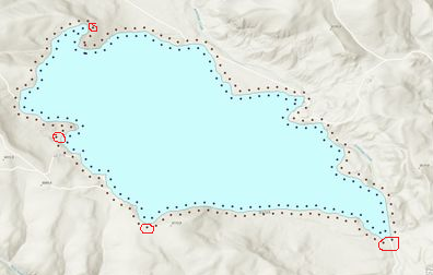

I have two datasets of points that exist on either side of a buffered line (one that resides inside of a buffer and one that resides outside). I am going to take values of each point based on vegetation classes found in an underlying raster layer and compare those that are directly across from one another along the buffered line.
What I am trying to work out is how I can match the points that are across from one another into a new dataset?  Or, is there a way I can create a common field with a common value that will can be shared between the adjacent points that will ensure that the points that are directly across from one another will inherit that same value?
Here is a pic of the points that I am trying to match for further analysis:
Thanks

I agree with @DanPatterson , you need to explain how these points were created in the first place.  A simple visual scan of your image and it is obvious there is NOT a 1-1 match. I highlight several examples in your image. How do you want to process these?
How were these points created, why have you allowed  to have points unmatched? As Dan hints a near tool will erroneously identify points because some will be nearer to their adjacent rather than cross border.
Finally how many lakes are to be processed, if it really is this one, by hand may be quicker rather than develop up a workflow to capture all cases?

Your points don't actually pair up (look at the sharp corners), so you'll have problems getting a 1-1 relationship to work.

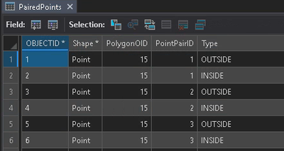

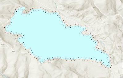

If you want to get a 1-1 relationship, you have to generate your points differently. Copy and edit this Python script, then run it in the Python window:
polygon_layer = "TestPolygons"
point_distance = 500
buffer_distance = 100
# create output fc
points = arcpy.management.CreateFeatureclass("", "PairedPoints", "POINT")
arcpy.management.AddField(points, "PolygonOID", "LONG")
arcpy.management.AddField(points, "PointPairID", "LONG")
arcpy.management.AddField(points, "Type", "TEXT")
# generate points ON the line
points_on_lines = arcpy.management.GeneratePointsAlongLines(polygon_layer, "PointsOnLines", 'DISTANCE', point_distance)
# read the polygon geometries as dict {OBJECTID: Geometry}
polygon_shapes = {p[0]: p[1] for p in arcpy.da.SearchCursor(polygon_layer, ["OID@", "SHAPE@"])}
# start inserting points into the output fc
with arcpy.da.InsertCursor(points, ["SHAPE@", "PolygonOID", "PointPairID", "Type"]) as i_cursor:
    # loop through the points on the line
    with arcpy.da.SearchCursor(points_on_lines, ["SHAPE@", "ORIG_FID", "OID@"]) as s_cursor:
        for shp, poly_id, point_id in s_cursor:
            # get the polygon this point is on
            poly_shp = polygon_shapes[poly_id]
            # create a small buffer around the point
            p_buffer = shp.buffer(0.01)
            # get the 2 points where the buffer intersects with the polygon
            i_points = p_buffer.intersect(poly_shp, 1)
            sr = poly_shp.spatialReference
            fp = arcpy.PointGeometry(i_points.firstPoint, sr)
            lp = arcpy.PointGeometry(i_points.lastPoint, sr)
            # calculate the angle between those points -> line angle at the curretn point
            angle = fp.angleAndDistanceTo(lp)[0]
            # create two points perpendicular to the line
            p1 = shp.pointFromAngleAndDistance(angle + 90, buffer_distance)
            p2 = shp.pointFromAngleAndDistance(angle + 90, -buffer_distance)
            # calculate if the points are inside or outside the polygon
            p1_type = "OUTSIDE" if p1.disjoint(poly_shp) else "INSIDE"
            p2_type = "INSIDE" if p1_type == "OUTSIDE" else "OUTSIDE"
            # insert both points
            i_cursor.insertRow([p1, poly_id, point_id, p1_type])
            i_cursor.insertRow([p2, poly_id, point_id, p2_type])
