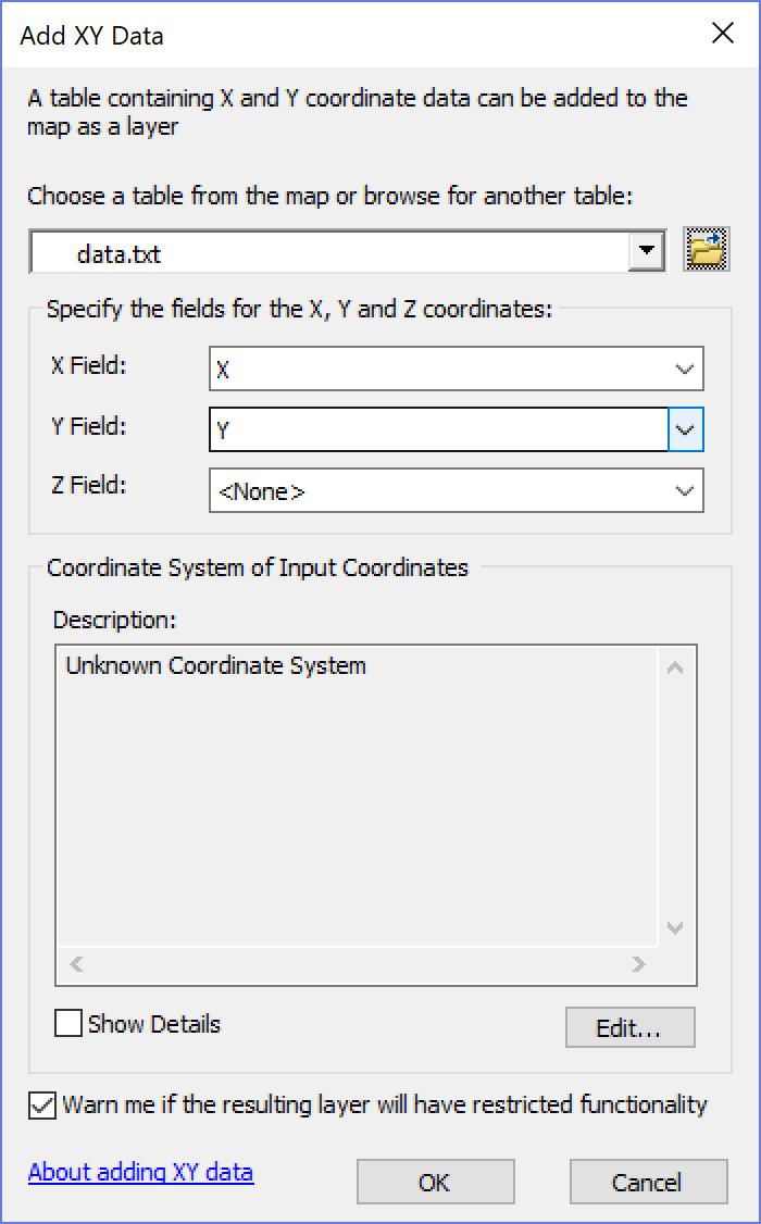

could you please help me to import this TXT file into ArcMap.
My trials are ending with the error message
I do not knwo what is wrong with this file.
Thank you in advance

Presumably you made this in some other program like Excel.
You would be advised to save it as a comma-separated values file rather than space-delimited.  you should then be able to add it as an Event Layer.
Also, make sure there are no blank lines at the end of the file.

Dear Dan,
in my file there are no blank lines. Moreover, although I save the file as a comma-separated file, I still can not create an Event Layer, because there are no values to be chosen as X and Y
Here I attach the file again.
ob11_92.txt - Google Drive
I would be grateful if you could help me solve this problem.

works in 10.6 and pro
I will attach a shapefile

Yes, I know, but why it doesn't work in 9.3.1?
XanderBakker
Esri Esteemed Contributor
During the year many enhancements may have been implemented in the software.  We are currently at version 10.6 and 9.3.1 was retired more than 4 years ago. In case you can, please update. In case you can't use, the data processed and offered to you. In case you have a lot of file to process, maybe a script can be written to help you process the files.

What version of ArcMap are you using?  And when you say, " import this TXT file into ArcMap," how exactly are you trying to import it?
I am running ArcMap 10.6, and I have no problem loading the file using "Add Data..." in the menu.
MalgorzataMendela
I am using ArcGIS 9.3.1 and I am trying to import this file by Tools->Add XY Data
