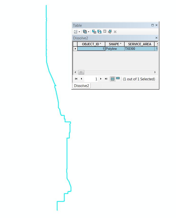

I am having issues with the Split tool.  When I try and split a line at a given point my result is not  a new feature where the break was meant to occur.
This is my line (one feature)

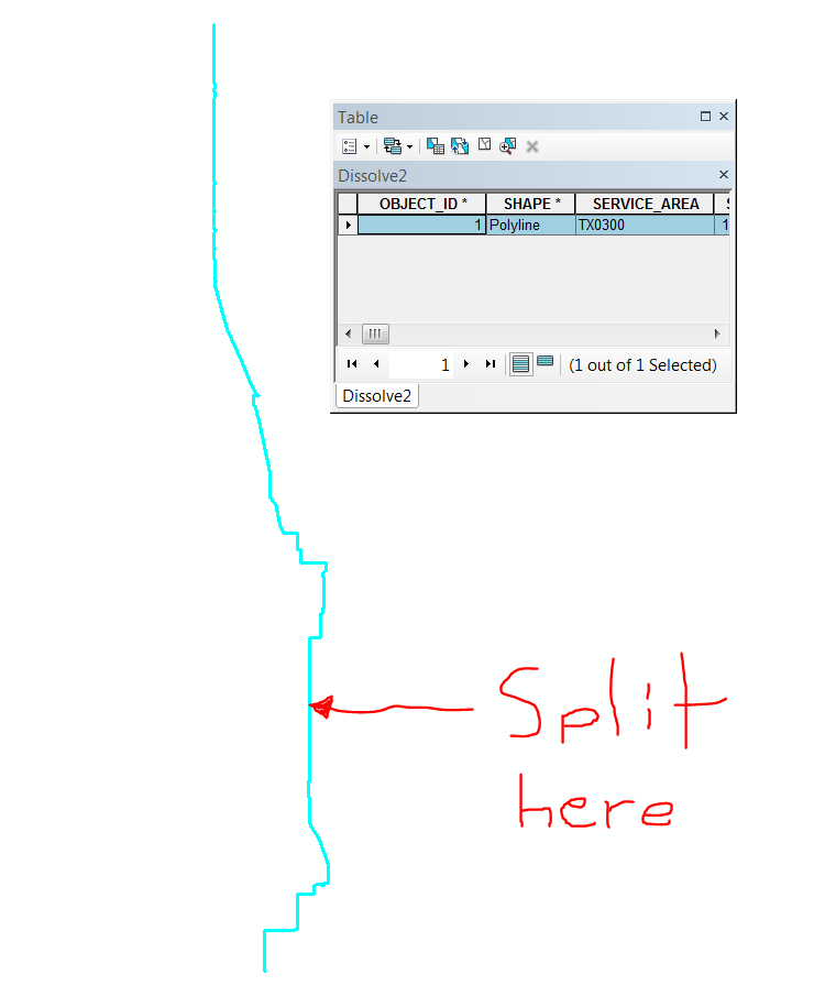

This is where I place the cursor for the split to happen.

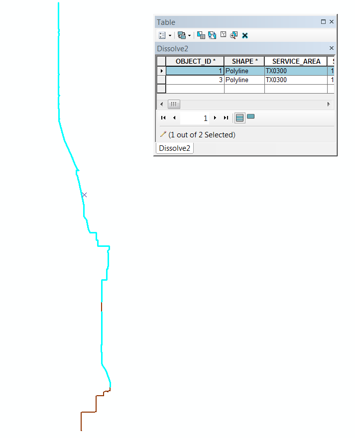

The result is two lines but they are not as expected....I want one line North of where I put the split tool and another South of where I put the split tool....instead I have a small segment of line two in the middle of line one.

@Travis_lathrop Could it be that the vertices are out of order or that the source data (assuming it was from AutoCAD or something of the like) had a polyline that doubled back on itself?
To me, it looks like a "Multipart" polyline. That is the only time I have experienced something like this. Perhaps on the original unsplit line edit your vertices and select the ones in both areas that appear to be separated and see if the vertice are numbered sequentially or not.
If you merged the small line (which appears to be a segment of the larger segment since the are highlighted and only one feature is selected in your table) with the line(s) to the south as suggested by Jake Skinner, you would definetely have a mulipart polyline. I think then you'd be back at square one so to speak.
Make a new field in your table and run this python script !shape.isMultipart! or just edit your vertices for the newly split line and it will immediately show you if it is a multipart or not.
Hopefully this helps, let me know what happened if you don't mind. Of course, I could be wrong.
ChrisDonohue__GISP
MVP Alum
My guess is that Jerad White is on to the root cause.  If that is the case, another way to potentially fix it is to run the Repair Geometry (Data Management) geoprocessing tool.
