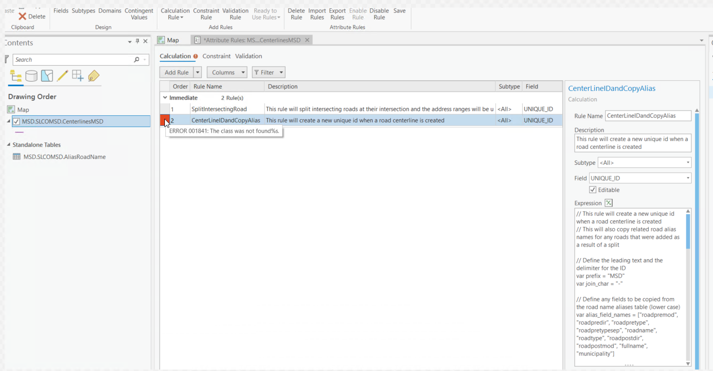

I found a thread thread that mentions the same error ArcGIS PRO 2.1.3 brought new defect - ERROR 001841: The class was not found%s. Failed to execute (As... from 2018.  I'm getting the same basic error when trying to validate the Centerline ID and Copy Road Aliases rule in the Address Data Management Solution that I'm trying to get to work in an EGDB environment.
The table AliasRoadName is present in the $datastore (my egdb where the centerlines reside as well.)  This rule is integral to the Split Intersecting Road Tool so if the Centerline ID and Copy Road Aliases rule doesn't work, neither will the  Split rule.  The rule that won't validate is a copy from my original proof of concept project that I got to work in a fgdb, and it worked there.
I'm wondering if this is just a generic error that is being returned that is meaningless for the issue at hand, but as with anything arcade, you are at the mercy of what it returns when it fails.  Below is the rule that tosses the error.  You'll notice i don't reference lines 5 & 6 further down in line line 14, opting just for the number my sequence returns.
Earlier today, I posted List Database Sequences for Enterprise Geodatabase in which I question how to verify if a sequence exists in an EGDB:  I created a scratch point feature class and created a rule that calls the sequence listed below and created a point.  The sequence does in fact exist and the proper incremented sequence value populates the appropriate field in the point attribute table, so that proves to me that a sequence can be added and utilized in an egdb.

I just went ahead and saved the the rule in spite of the red box and error. I then simply added a new centerline without splitting an existing centerline.  I am am able to do that and the ID sequence fires. Intrigued, I added a second new centerline that intersects the first new center line.  Holy cow!  That works too!  Mind you, I have not updated any of the attribute data in these new roads.
However... Now when I try to add a new centerline that splits one of my existing centerlines, I get the error shown below, which is one I fought for quite sometime when working in the fgdb arena and my proof of concept project.  I could never figure it out; the only way I am able to use the Address Data Management Solution is to use the ESRI prescribed feature class names and schemas.
