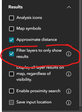

JeffreyThompson2
MVP Frequent Contributor
@alro_avineon I think the answer is it would have to be a Custom Widget, but try playing around with the Filter Layers To Only Show Results option. There might be a hack you could do with that. Maybe involving a third Near Me Widget.
