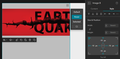

Hey, actually, what you have to do is:
- On the Default state, set dimensions to stretch
- On the Hover state, do the same but offset the image negative pixels to each side

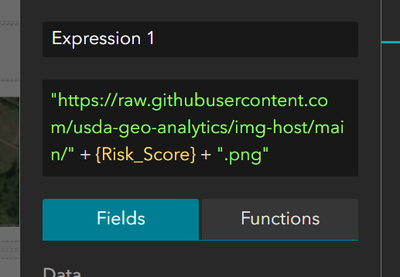

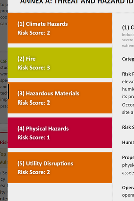

Specifically I needed the gory details on how to use images (in my case just solid color pngs blanketing the background of the list item) dynamically via an expression...voila!

@AlderMaps Using colored boxes as dynamic images is a clever trick for dynamic backgrounds. Could you write it up as a separate post?

I edited the post with a more explicit how-to for this step. It goes something like this.
  1. Create a series of 1x1 pixel colored squares and save them somewhere on the Internet that your site will be able to access. Hosted Images on ArcGIS Online, perhaps?
  2. In your table/data that you will use to control the colors, have a field that contains the full URL to these colored squares.
  3. As the background of your List Widget, use an Image Widget with an Dynamic URL based on the field that points to the colored squares.
