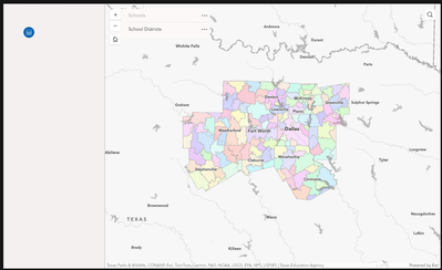

  1. Starting with a Blank Fullscreen Template, we add a Sidebar Widget and set it to Full Size.
  2. In the Always Open Side, we put a Map and a Map Layers Widget.
  3. In the Collapsible Side, we put a Widget Controller.

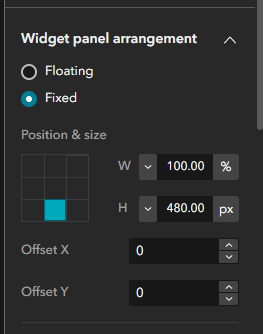

  5. In the Widget Controller Settings, set the Widget Panel Arrangement to Fixed, the Width to 100% and use the Center-Bottom Square.JeffreyThompson2_1-1769183297216.png

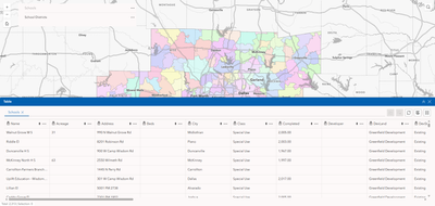

The result:
Clicking Add To Table automatically triggers the hidden Widget Controller and opens the Table Widget. Users can close the Table with the X button or use the Arrows to minimize it, which isn't an option in ArcGIS Pro for some reason. It won't automatically un-minimize or prevent you from adding the same table twice, but all-in-all, I think it's a pretty slick presentation, maybe better than the Webmap Viewer or ArcGIS Pro.
