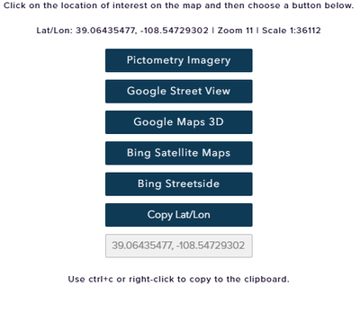

I have create an Enhanced Coordinate Widget display, with quick-link to Google3D
  • Very simple (just drag&drop and link to the map)
  • Works with 2D maps and 3D scenes
  • Shows Zoom level,  Scale,
  • Optionally shows Tilt (3D) and rotation
  • Can customize background color

Update on 3/24/25: I have added the function to disable pop-ups and feature highlights for when the widget is in use. The ZIP file at the top of this thread has been updated.
Brian_McLeer
MVP Regular Contributor
Update on 3/27/25: Updated how buttons appear before user clicks on map. The buttons are always present, but greyed out until user clicks on the map.
Brian_McLeer
Update on 3/28/25: Add accessibility updates to add tooltips when hovering over buttons.
Brian_McLeer
Update on 5/21/25: Add Bing Satellite and Streetside links.
Brian_McLeer
Update on 5/23/25 Added updates to the configurations in DEV so that buttons can be toggled on/off (for example showing Google Maps 3D but turning off Google Street view). The other update is that the URL for Pictometry can now be configured in the DEV settings. With both of these updates, there is no need to go into the code to customize to your parameters and can all be done in Developer Edition.

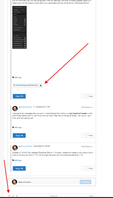

Hi Brian,
Where can I download your widget?
Brian_McLeer
Hello @YuvnaApajee_8, the widget is at the top of this thread, I reply to myself for each changelog event. If you go to page 1 of this community post and look towards the bottom, you will see it there.
