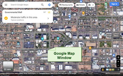

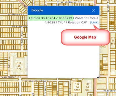

This is how your Widget appears:
It tracks the Lat/Long Coordinates as you move the cursor over the map.
When you click on the [Link], it opens a separate Google Maps Window.
https://www.google.com/maps/@33.44849,-112.09398,1131m/data=!3m1!1e3?entry=ttu

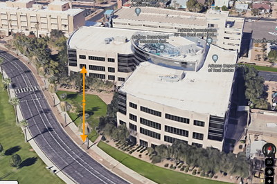

You can hold down the Control Key while dragging your mouse to get the full 3D experience in Google Maps.
To change the Tilt, move the mouse up or down while holding down the Control Key.
To change the Rotation, move the mouse to the left or right while holding down the Control Key.

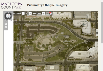

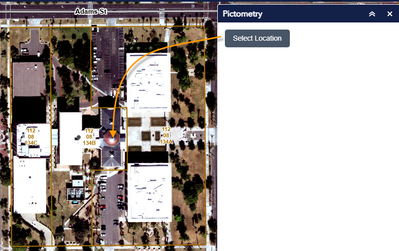

Open the Pictometry Widget.
You get a button to Select a Location.
Click on the State Capitol.
This opens a separate Pictometry Window with this URL:
https://gis.maricopa.gov/pictometry/default.aspx?&qlat=33.44806452764903&qlong=-112.09737111757926

I was able to modify your custom widget to turn it into our Pictometry Widget.
Your widget captures the Lat/Long coordinates of the centroid of your map and constructs the necessary URL to launch Google Maps in a separate window.
Here is an example of the Google 3D URL:
https://www.google.com/maps/place/@33.44849,-112.09398,489a,35y,0.0h,0t,489m/data=!3m1!1e3
This widget can be easily repurposed to open a Pictometry Window which requires the same Lat/Long coordinates to be formatted in a different way like so.
https://gis.maricopa.gov/pictometry/default.aspx?&qlat=33.44849&qlong=-112.09398

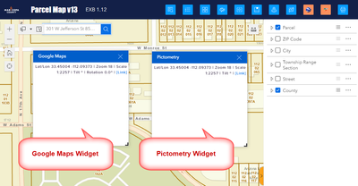

I am including a ZIP file that shows the changes that were made to make create the Google Maps and Pictometry Widgets and make them work in EXB Developer Edition 1.12 with Node.js 14.21.3.
Here is how I got them working side by side.
The Google Map Widget launches the Google Maps Window.
https://www.google.com/maps/@33.44849,-112.09398,518m/data=!3m1!1e3?entry=ttu
The Pictometry Widget launches the Pictometry Window.
The included ZIP file contains the fully configured Google Maps and Pictometry Widgets and a ReadMe PDF that contains all the instructions.

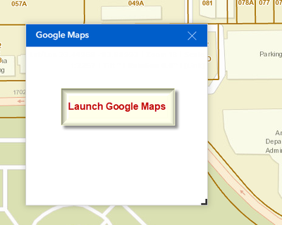

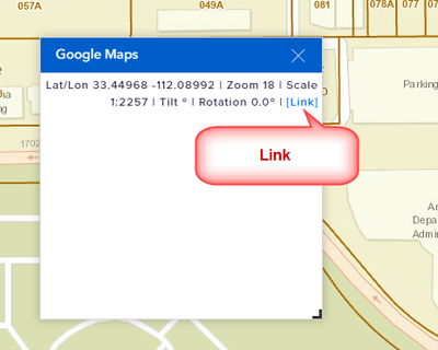

I have one enhancement request.
Could you change the [Link] into a large button?
Before:
After:

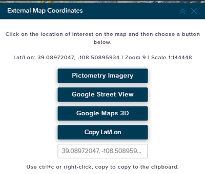

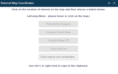

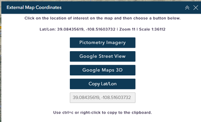

@FredericPoliart_EsriAU @DavidDas__GISP @ZhujingXia I have worked on David's most recent download above and modified it with the following:
  • Allow hyperlinks to multiple URLs based on coordinates (Pictometry, Google Street View, Google Maps, Copy Lat/Long.
  • Have the user hover and click on the map, then click on buttons to be linked out to the page.
  • Remove Tilt/Rotation
  • For my application, we publish in this WGS 84 / UTM zone 12N. Functionality has been added to convert from that system to Web Mercator or WGS84, which is a similar issue @ZhujingXia posted about on 10/3/23.
  • Changed icon.svg to a map pin.
  • Built on Experience Builder Developer Edition 1.15.
@FredericPoliart_EsriAU @DavidDas__GISP I updated the manifest.json to include you both as authors and and updated description. I can post the updated widget to this message thread, but wanted to get your thoughts first.

Update on 11/19/24: Fixed an issue where closing the widget on the toolbar and reopening it caused the widget to remain active at the previous location with buttons not greyed out, even though no point was present on the map. This issue also prevented users from adding a new point, as the widget continued to launch from the prior location state instead of resetting. The ZIP widget below has been updated with the bug fix.
Update on 12/4/24: Esri released Developer Edition 1.16 today. I tested the widget on this version and it looks to function as it did in 1.15. I ran through the same npm commands as above for 1.16.
Update on 3/24/25: I have added the function to disable pop-ups and feature highlights for when the widget is in use.
Update on 3/27/25: Updated how buttons appear before user clicks on map. The buttons are always present, but greyed out until user clicks on the map.

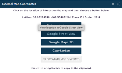

Update on 3/28/25: Add accessibility updates to add tooltips when hovering over buttons.

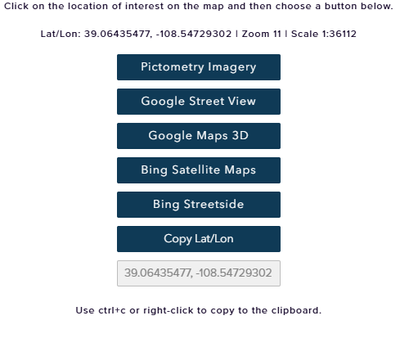

Update on 5/21/25: Add links to Bing Satellite Maps and Bing Streetside.
Update on 5/23/25 Added updates to the configurations in DEV so that buttons can be toggled on/off (for example showing Google Maps 3D but turning off Google Street view). The other update is that the URL for Pictometry can now be configured in the DEV settings. With both of these updates, there is no need to go into the code to customize to your parameters and can all be done in Developer Edition.
Update on 11/13/25: Breaking changes going from DE 1.18 to 1.19:
Experience Builder 1.19 introduces two critical breaking changes that prevent widgets built for 1.18 from loading. First, the WidgetState enum has been removed from 'jimu-core', requiring developers to replace WidgetState.Opened with the string literal "OPENED" in widget lifecycle methods. Second, and more significantly, the jsx() function signature has changed to align with React 17+'s new JSX transform—children must now be passed as a children property within the props object rather than as separate function arguments. This means jsx('div', {props}, child1, child2) must be rewritten as jsx('div', {props, children: [child1, child2]}) throughout the entire render method. While this is a substantial refactoring effort requiring updates to every jsx call in your widget, it brings Experience Builder in line with modern React standards and is a one-time migration requirement for the 1.18 to 1.19 upgrade path.
12/10/2025 (for 1.19 version only):
  • Theme Typography Update – All widget text now uses Experience Builder’s Theme Typography for consistent styling.
  • Accessibility Improvements – Added multiple WCAG-compliant updates across widgets for better usability and accessibility.
Update on 03/26/26: Breaking changes going from DE 1.19 to 1.20. Fix has been applied, both 1.19 and 1.20 available for use.
7/23/26: Updated for DE 1.21
