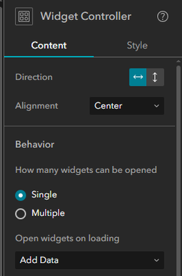

You can place them in a Widget Controller and use the Open Widgets On Loading property.

The Widget Controller supports an Action that can open another Widget on Button Click or Record Selection Changes.
https://doc.arcgis.com/en/experience-builder/latest/configure-widgets/widget-controller-widget.htm
Assuming you are looking to do this programmatically in a way not supported by these existing Actions, it should be possible to trigger this Action somehow in the Message Interface.
https://developers.arcgis.com/experience-builder/api-reference/jimu-core/Message/
