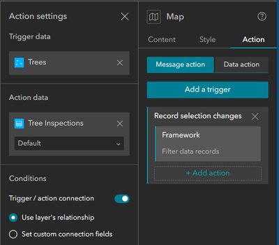

Hi @West-d-gis ,
Related data is recognized within the Experience Builder data sources. When you configure Message actions between widgets, you can set Filter records. For example with the configuration below, when a Tree feature will be selected, it's related table records will also be selected.
This is available in ArcGIS Online and starting at Enteprise 11.4.

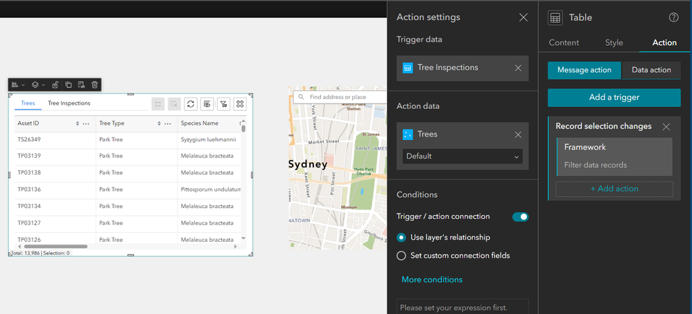

West-d-gis
Unfortunately, what we would want is a reverse of the points being the Trigger. We would want to filter by the related table and then have that go backward to the related feature class (in your example it would be the Tree Inspections as the Trigger for the filter and the action be the points). That did not seem possible in AGOL.
AlixVezina
Hi @West-d-gis , setting up the actions in reverse should also work in Experience Builder > with the selected related record filtering features from the parent layer!
