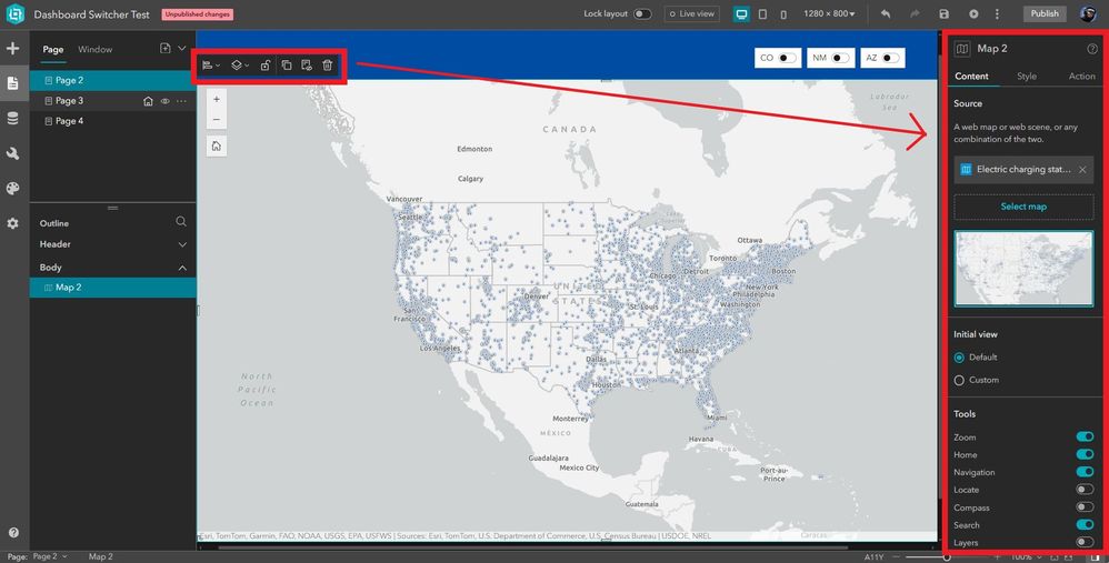

Right Configuration Panel
On the canvas, it is likely you will have many widgets on your page. When you select a widget on the canvas, firstly there is a toolbar for each selected widget that appears top left of the selected widget and secondly the right configuration panel (or settings panel) becomes activated for that widget. The right configuration panel changes based upon whatever widget is selected. For example, in the graphic below, I have selected the map widget. Within the right configuration panel, I now have the configuration tabs for the map widget – Content, Style, and Action.
Right Configuration PanelRight Configuration Panel
